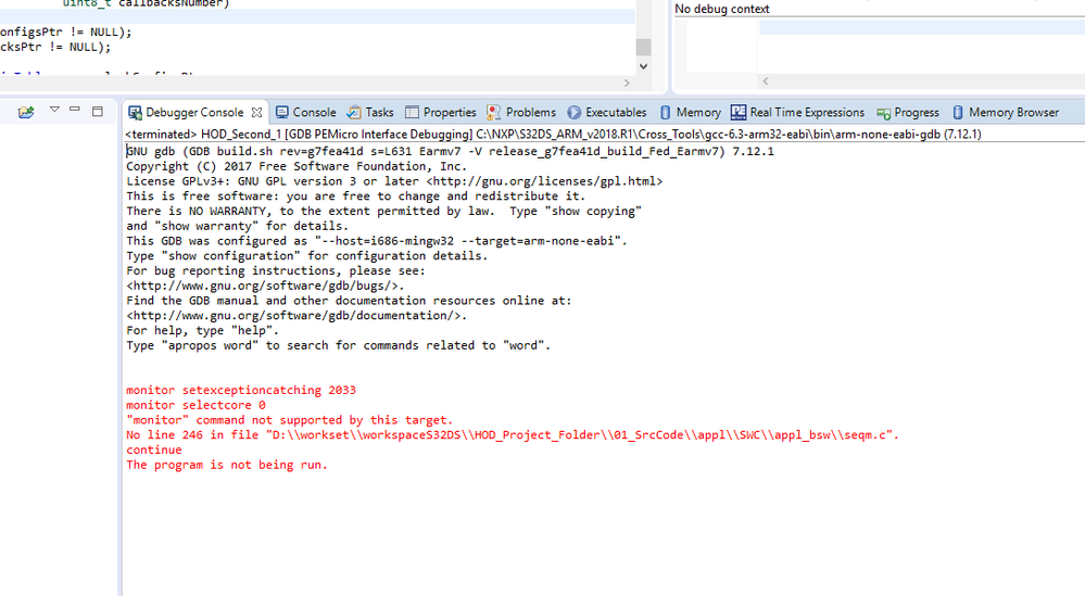

Hello
   Now I meet a question, when I click debug,  and connect target, download code, During download S32DS suddenly closed the connect. the prompt information is as below picture:
 But I unplug the power supply and use multi Link to supply power separately, click the debug button, everything is OK. the debug configuration are all the same.
  The S32DS version  is 2018.R1,the driver is newest, and have updated. the multi Link use the Multi Link Universal FX rev c.

Hello
    this question has been solved. After I check the hardware, and measure the wave of  pin reset, the wave is not correct. the reset signal have affected the debug.

asd046012
Hello
    As above, the circuit is the reset circuit, when the R0124(22k) is replaced by a small resistance, for example R22. and use power supply, and connect Multi Link, click debug button, everything become normal,  I could debug, download code, but when I send a hard rest diagnostic command, the MCU couldn't reset, because the pin reset couldn't be pulled down to low level.
    I have tried many times.  Now I don't know how to try, could you give me any advice?

asd046012
Hello
