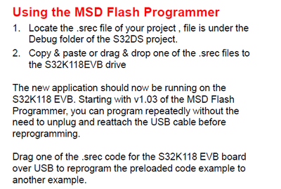

I am using S32DS working on S32K118 EVB, I setup few projects (some for testing):
1) In some project, there are no "Standard S32DS Create Flash Image" under Project property->C/C++ Build->Setting, so How to add it in? (because I want to generate .srec file and Using the MSD Flash Programmer to flash).
2)I copy one .srec file and put into S32K118 folder to try the "Using the MSD Flash Programmer", the LED near USB port start to blinking, when and what is the indication for the flashing progress is done?
Thanks and best regards
He Wei
6,004件の閲覧回数
jiri_kral
I don't have S32K118 board, but the principle is same. You need to copy .srec file to EVB mass storage drive which is created when EVB is connected to PC.
The LED close to USB starts flashing for a while and your program is started when s-record is flashed. To figure out if your program is running, you can attach to running target. Other possibility is add some "I'm alive" message for example by LED flashing.

Thanks a lot. it works!. Actually I try to load the .srec using the MSD Flash programmer way:
After drag and put the .srec file, LED D2 start to blinking, but it seems the blinking never end and flashing didn't success.
Can you advise what is the procedure to load this .srece file? and what is the indication when flashing is done?
