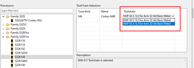

S32DS V3.3 New application project unable to find SDK

Hello @turbozzg ,

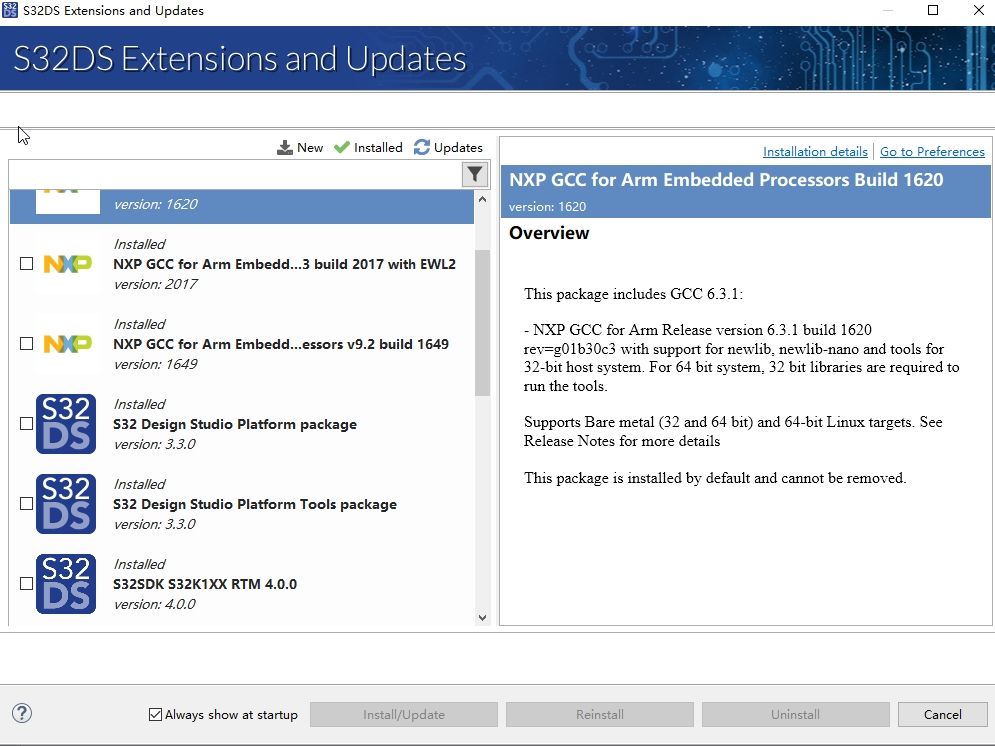

The S32SDK S32K1XX RTM 4.0.0 does not support GCC 9.2. This is noted in "C:\NXP\S32DS.3.3\S32DS\software\S32SDK_S32K1XX_RTM_4.0.0\S32SDK_for_S32K1xx_RTM_4.0.0_ReleaseNotes.pdf"
You will need to first select the 'NXP GCC 6.3 for Arm 32-bit Bare-Metal' toolchain in order to select the SDK.
Mike
