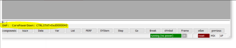

I am facing issue while flashing the S/W in S32K144 MCU. For flashing,  i am using lauterbach debugger.
For your information , I observed that the MCU reset Pin always LOW.
The below error is observed from debug window.
I have used below Script. during System UP and i am facing above issue.

well, I never met such issue - especially with Lauterbach. It looks as a some HW issue - you probably did some basic checking - but can you confirm that MCU is properly powered, clock is working and So on?

rangarajan_arum
Hi jiri
MCU is powered - VDD 5V
                              VDA 5V
Board current consumption- 0.010A (compare to operating mode consuming very less)
Additional Information
Before connecting JTAG
Clock - 0V
RST-    0V (connected with pull up resistor but still it shows 0V)
TDI -    5V
TDO -  5V
TMS-   5V
Vref -  5V
GND- 0V
RST pin is observed as 0V when there is no-connection as well as while connected with pull-up
After connecting JTAG
Clock - 0V
RST-    0V
TDI -    5V
TDO -  0V
TMS-   0V
Vref -  5V
GND- 0V
just to confirm
1) Is internal clock is used for fleshing the S/W in MCU?
2) Are there any chances the previous flashed SW corrupted the MCU?
4,069件の閲覧回数
jiri_kral
yes, it is possible that previously flashed program may lock up chip by disabling mass erase and secure chip on flash config address (0x400). In this case is JTAG physically cut off and the only way (as far as I know) is replace chip with new one.
