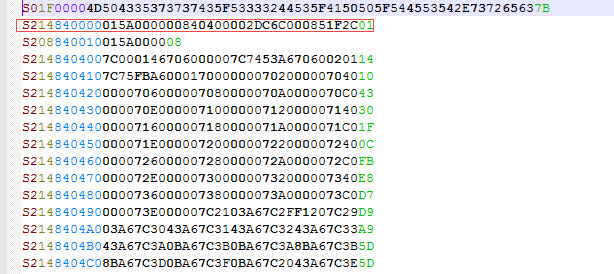

I used MPC57XXMB-REVA development version, the following is the APP application generated. Srec opening file format  ,I will download this file into the development version using the Rappid BL Tool tool.  Unable to run APP program after reset.  After more than 3S, it can still be loaded again (guess it stops in the bootloader)

1. The RBF file address on the official website is not from 0x20000 to 0x2FFFF
2. The Flash. id setting of my app is shown in the following picture. It cannot be downloaded through the Rappid BL Tool.
3. Does the interrupt vector in my app need to be mapped again? How to map

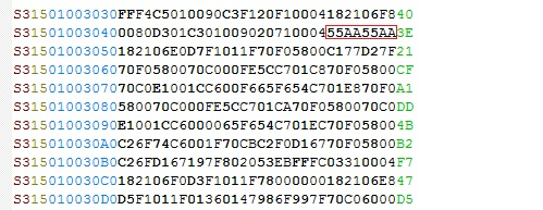

  • Modify the linker file as shown below by adding a new line *(.appKey) into the .text segment:
Figure 6.2.2
  • The example output .srec file generated by the compiler integrated in S32 Design Studio:
  • The first part of the file:
Figure 6.2.3
  • The last part of the file:
Figure 6.2.4
