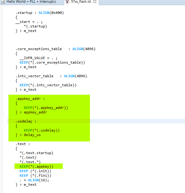

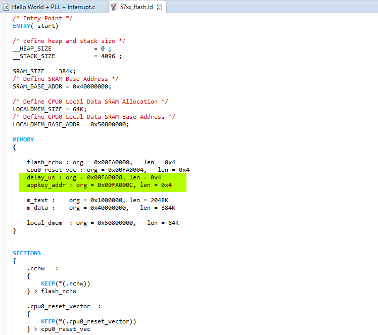

1. Modify your application to be compatible with RAppID BL tool. Add memory space for delay and application key in linker file (modified hello world project is in attachment):

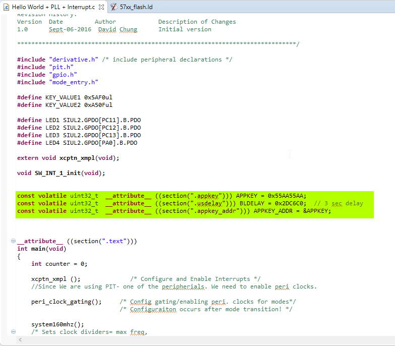

Add data for this sections in your app (for example in main.c file):

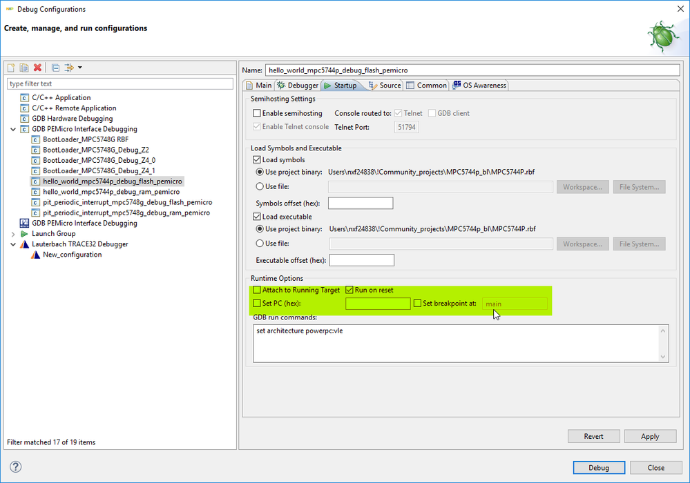

2. Flash MPC5744P.rbf file into MCU. You can create new empty project or use existing one. Start debug Configurations and Browse MPC5744P.rbf file (located in [YOUR_RAPPID_INSTALL_FOLDER]\RBF_Files. Start debug session.

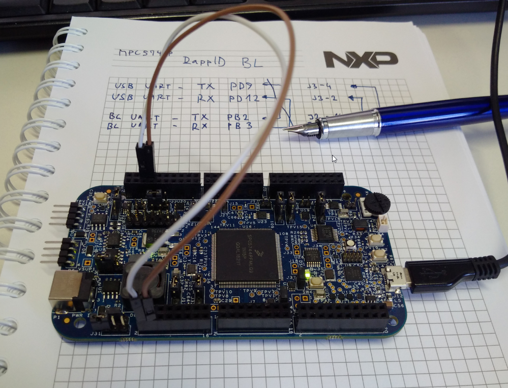

3. Modify your EVB - add jumper wire from J3-4 to J2-16  and J3-2 to J2-14. RAppID uses UART0 and to USB is connected UART1.

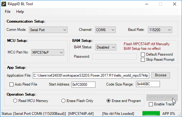

4. Start RAppID BL tool, select COM port where EVB is connected,  choose your s-record file and Start Boot Loader:
