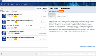

Sachin05
Hello @VaneB
RTS version
FreeRTOS package version
followed the standard NXP example import procedure from the S32 Design Studio 3.6.2 IDE:
  1. Opened S32 Design Studio 3.6.2 IDE
  2. Navigated to Dashboard → "Create or import project"
  3. Selected: "S32DS Project from Example"
  4. Filter/Search Parameters:
    • Category: TCP/IP Stack (or Middleware)
    • Device Family: S32K3X4
    • Example Name: lwip_freertos (or similar variant like free_rtos_tcpip)
  5. Selected the example from the list
  6. Clicked "Finish" to import into workspace
No custom modifications were made to the imported project before the initial build attempt.
Regards, Sachin

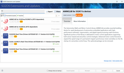

1,519件の閲覧回数
VaneB
Hi @Sachin05
Could you please provide the RTD version and the FreeRTOS package version you have installed? Additionally, could you share the steps you followed to import the example? This will help me better understand your setup and verify if anything might be missing.
BR, VaneB
