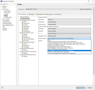

i use gcc 10.2, don't have ewl_c9x, how i can enable printf with uart port
i see there is link:
use below configure,
https://community.nxp.com/t5/S32-Design-Studio-Knowledge-Base/Example-S32K-printf-implementation-S32...
9 Replies
5,056 Views
Julián_AragónM

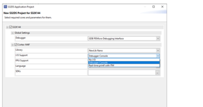

Hi @alice_th,
You can use NewLib/NewLib Nano with Debugger Console I/O support with GCC 10.2:
or downgrade the toolchain version (6.3) and use EWL:
Julián

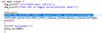

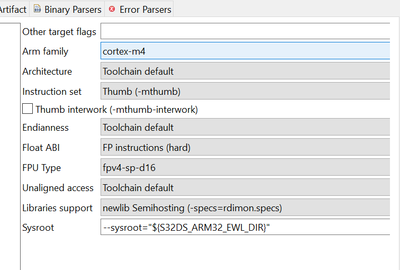

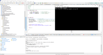

alice_th
i want use the real uart print with terminal, you link only work with  semihosting console.
i already add this code, but no print on my terminal, please check , thanks!
int _write(int file, char *ptr, int len)
uint32_t bytesRemain;
size_t bytes=len;
unsigned char ret_car[]={"\r"};
LPUART_DRV_SendData(INST_LPUART1, ptr, bytes);
while(LPUART_DRV_GetTransmitStatus(INST_LPUART1, &bytesRemain) != STATUS_SUCCESS);
LPUART_DRV_SendData(INST_LPUART1, ret_car, 1);
return len;
4,816 Views

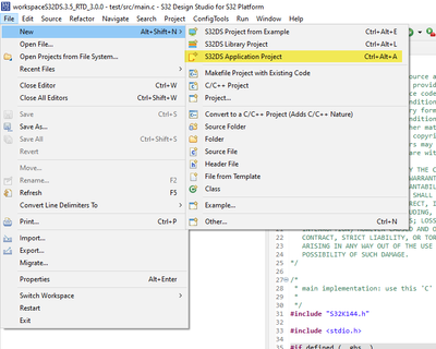

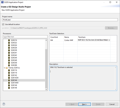

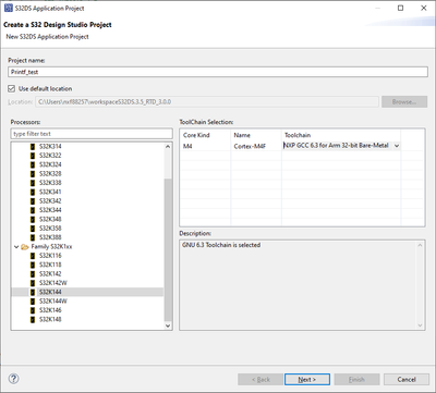

Julián_AragónM
Hi @alice_th,
You can use the example you posted. This example was designed for an older SDK, which can be flashed in S32DS.2018.R1 or you can create a new project (selecting GCC 6.3 compiler and EWL library) and copy over the configuration from the original post:
I've shared the ported project for S32DS3.5 RTD3.0.0.
Julián

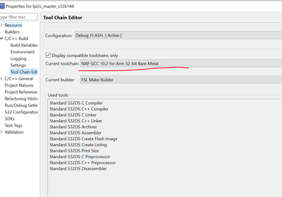

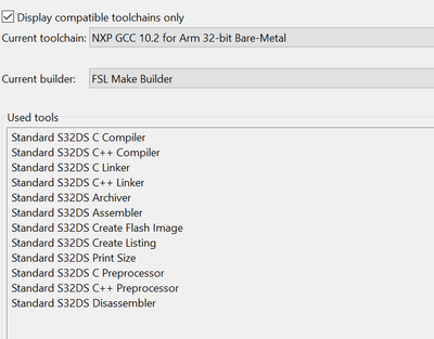

alice_th
if switch gcc , there will some error below, could you help to check
Building target: lpi2c_master_s32k144.elf
Invoking: Standard S32DS C Linker
arm-none-eabi-gcc -o "lpi2c_master_s32k144.elf" "@lpi2c_master_s32k144.args"
c:/nxp/s32ds.3.5/s32ds/build_tools/gcc_v10.2/gcc-10.2-arm32-eabi/bin/../lib/gcc/arm-none-eabi/10.2.0/../../../../arm-none-eabi/bin/real-ld.exe: ./SDK/platform/drivers/src/interrupt/interrupt_manager.o: in function `INT_SYS_InstallHandler':
C:/NXP/S32DS.3.5/S32DS/software/S32SDK_S32K1XX_RTM_4.0.1/platform/drivers/src/interrupt/interrupt_manager.c:175: undefined reference to `__VECTOR_RAM'
c:/nxp/s32ds.3.5/s32ds/build_tools/gcc_v10.2/gcc-10.2-arm32-eabi/bin/../lib/gcc/arm-none-eabi/10.2.0/../../../../arm-none-eabi/bin/real-ld.exe: C:/NXP/S32DS.3.5/S32DS/software/S32SDK_S32K1XX_RTM_4.0.1/platform/drivers/src/interrupt/interrupt_manager.c:175: undefined reference to `__VECTOR_TABLE'
c:/nxp/s32ds.3.5/s32ds/build_tools/gcc_v10.2/gcc-10.2-arm32-eabi/bin/../lib/gcc/arm-none-eabi/10.2.0/../../../../arm-none-eabi/bin/real-ld.exe: C:/NXP/S32DS.3.5/S32DS/software/S32SDK_S32K1XX_RTM_4.0.1/platform/drivers/src/interrupt/interrupt_manager.c:175: undefined reference to `__DATA_ROM'
c:/nxp/s32ds.3.5/s32ds/build_tools/gcc_v10.2/gcc-10.2-arm32-eabi/bin/../lib/gcc/arm-none-eabi/10.2.0/../../../../arm-none-eabi/bin/real-ld.exe: C:/NXP/S32DS.3.5/S32DS/software/S32SDK_S32K1XX_RTM_4.0.1/platform/drivers/src/interrupt/interrupt_manager.c:175: undefined reference to `__DATA_END'
collect2.exe: error: ld returned 1 exit status
make: *** [makefile:46: lpi2c_master_s32k144.elf] Error 1
"make -j8 all" terminated with exit code 2. Build might be incomplete.
11:19:43 Build Failed. 5 errors, 0 warnings. (took 28s.674ms)
4,994 Views
alice_th
if switch the gcc tool, then rebuild project, always have these error, what is the problem ?
c:/nxp/s32ds.3.5/s32ds/build_tools/gcc_v10.2/gcc-10.2-arm32-eabi/bin/../lib/gcc/arm-none-eabi/10.2.0/../../../../arm-none-eabi/bin/real-ld.exe: error: lpi2c_master_s32k144.elf uses VFP register arguments, ./board/clock_config.o does not
c:/nxp/s32ds.3.5/s32ds/build_tools/gcc_v10.2/gcc-10.2-arm32-eabi/bin/../lib/gcc/arm-none-eabi/10.2.0/../../../../arm-none-eabi/bin/real-ld.exe: failed to merge target specific data of file ./board/clock_config.o
c:/nxp/s32ds.3.5/s32ds/build_tools/gcc_v10.2/gcc-10.2-arm32-eabi/bin/../lib/gcc/arm-none-eabi/10.2.0/../../../../arm-none-eabi/bin/real-ld.exe: error: lpi2c_master_s32k144.elf uses VFP register arguments, ./board/peripherals_edma_config_1.o does not
c:/nxp/s32ds.3.5/s32ds/build_tools/gcc_v10.2/gcc-10.2-arm32-eabi/bin/../lib/gcc/arm-none-eabi/10.2.0/../../../../arm-none-eabi/bin/real-ld.exe: failed to merge target specific data of file ./board/peripherals_edma_config_1.o
c:/nxp/s32ds.3.5/s32ds/build_tools/gcc_v10.2/gcc-10.2-arm32-eabi/bin/../lib/gcc/arm-none-eabi/10.2.0/../../../../arm-none-eabi/bin/real-ld.exe: error: lpi2c_master_s32k144.elf uses VFP register arguments, ./board/peripherals_lpi2c_config_1.o does not
c:/nxp/s32ds.3.5/s32ds/build_tools/gcc_v10.2/gcc-10.2-arm32-eabi/bin/../lib/gcc/arm-none-eabi/10.2.0/../../../../arm-none-eabi/bin/real-ld.exe: failed to merge target specific data of file ./board/peripherals_lpi2c_config_1.o
c:/nxp/s32ds.3.5/s32ds/build_tools/gcc_v10.2/gcc-10.2-arm32-eabi/bin/../lib/gcc/arm-none-eabi/10.2.0/../../../../arm-none-eabi/bin/real-ld.exe: error: lpi2c_master_s32k144.elf uses VFP register arguments, ./board/peripherals_lpuart_1.o does not
c:/nxp/s32ds.3.5/s32ds/build_tools/gcc_v10.2/gcc-10.2-arm32-eabi/bin/../lib/gcc/arm-none-eabi/10.2.0/../../../../arm-none-eabi/bin/real-ld.exe: failed to merge target specific data of file ./board/peripherals_lpuart_1.o
c:/nxp/s32ds.3.5/s32ds/build_tools/gcc_v10.2/gcc-10.2-arm32-eabi/bin/../lib/gcc/arm-none-eabi/10.2.0/../../../../arm-none-eabi/bin/real-ld.exe: error: lpi2c_master_s32k144.elf uses VFP register arguments, ./board/peripherals_osif_1.o does not
c:/nxp/s32ds.3.5/s32ds/build_tools/gcc_v10.2/gcc-10.2-arm32-eabi/bin/../lib/gcc/arm-none-eabi/10.2.0/../../../../arm-none-eabi/bin/real-ld.exe: failed to merge target specific data of file ./board/peripherals_osif_1.o
c:/nxp/s32ds.3.5/s32ds/build_tools/gcc_v10.2/gcc-10.2-arm32-eabi/bin/../lib/gcc/arm-none-eabi/10.2.0/../../../../arm-none-eabi/bin/real-ld.exe: error: lpi2c_master_s32k144.elf uses VFP register arguments, ./board/pin_mux.o does not
c:/nxp/s32ds.3.5/s32ds/build_tools/gcc_v10.2/gcc-10.2-arm32-eabi/bin/../lib/gcc/arm-none-eabi/10.2.0/../../../../arm-none-eabi/bin/real-ld.exe: failed to merge target specific data of file ./board/pin_mux.o
c:/nxp/s32ds.3.5/s32ds/build_tools/gcc_v10.2/gcc-10.2-arm32-eabi/bin/../lib/gcc/arm-none-eabi/10.2.0/../../../../arm-none-eabi/bin/real-ld.exe: error: lpi2c_master_s32k144.elf uses VFP register arguments, ./src/SFH5721.o does not
c:/nxp/s32ds.3.5/s32ds/build_tools/gcc_v10.2/gcc-10.2-arm32-eabi/bin/../lib/gcc/arm-none-eabi/10.2.0/../../../../arm-none-eabi/bin/real-ld.exe: failed to merge target specific data of file ./src/SFH5721.o
c:/nxp/s32ds.3.5/s32ds/build_tools/gcc_v10.2/gcc-10.2-arm32-eabi/bin/../lib/gcc/arm-none-eabi/10.2.0/../../../../arm-none-eabi/bin/real-ld.exe: error: lpi2c_master_s32k144.elf uses VFP register arguments, ./src/console.o does not
c:/nxp/s32ds.3.5/s32ds/build_tools/gcc_v10.2/gcc-10.2-arm32-eabi/bin/../lib/gcc/arm-none-eabi/10.2.0/../../../../arm-none-eabi/bin/real-ld.exe: failed to merge target specific data of file ./src/console.o
c:/nxp/s32ds.3.5/s32ds/build_tools/gcc_v10.2/gcc-10.2-arm32-eabi/bin/../lib/gcc/arm-none-eabi/10.2.0/../../../../arm-none-eabi/bin/real-ld.exe: error: lpi2c_master_s32k144.elf uses VFP register arguments, ./src/main.o does not
c:/nxp/s32ds.3.5/s32ds/build_tools/gcc_v10.2/gcc-10.2-arm32-eabi/bin/../lib/gcc/arm-none-eabi/10.2.0/../../../../arm-none-eabi/bin/real-ld.exe: failed to merge target specific data of file ./src/main.o
10:22:32 Build Failed. 5 errors, 0 warnings. (took 19s.142ms)
