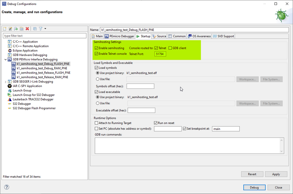

jiri_kral
easiest way is enable semihosting console. Anyway, what's your target device and debugger?

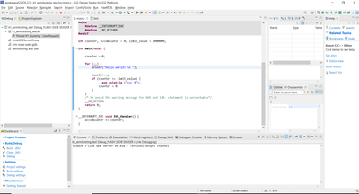

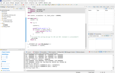

Gama
My target device is S32K144 and I am using a GBD SEGGER J-Link Debugging line to SWD.
I have enable semihosting as you suggested but no print showing .
here
after build and flash no results .
8,542 Views
jiri_kral
Did you switched to semihosting console? On your screenshot is shown debugger console:
8,498 Views
Gama
I have switch to the console but no results yet.  just to let you know I'm using a JTAG 20pin connection.
