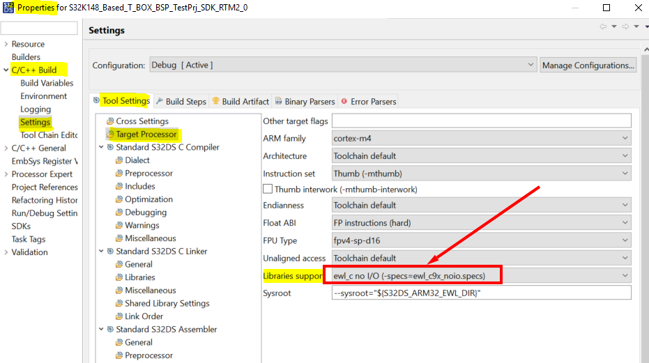

Hello Martin,
Great work and your project worked well for me.
However my project longer compiles when I copied your files (uart.c, uart.h, uart_console_io.c, clocks_and_mode.c & clocks_and_modes.h) into it.  My project is based on the "wdog_interrupt_s32k144 S32DS" example project and links with S32K14x EAR SDK v0.8.6. Your project links with EWL instead.
In my project I get this build error from uart.h
#if !_EWL_CONSOLE_SUPPORT
#error _EWL_CONSOLE_SUPPORT must not be defined to 1.
#endif
Also uart_console.io.c cannot include <ansi_parms.h> which defines _EWL_CONSOLE_SUPPORT.  This is because ansi_parms.h is located under "\nxp\S32DS_ARM_v2018.R1\S32DS\arm_ewl2\EWL_C\include" and that include path is not used by the "wdog_interrupt_s32k144 S32DS" example.
Can EWL include paths be added to an S32K14x SDK project?
Is it possible to redirect stdout to LPUART when using S32K14 SDK instead of EWL?
Apologies if these are dumb questions but I am new to the S32.
Thanks in advance
--MartinT
HI Martin,
I met the same issue as you, and it can be resolved with changing the project's runtime C library to EWL_C no I/O:
PS: the default library is newlib, which dose not work with the printf demo codes.
Best regard,
Enwei Hu.
