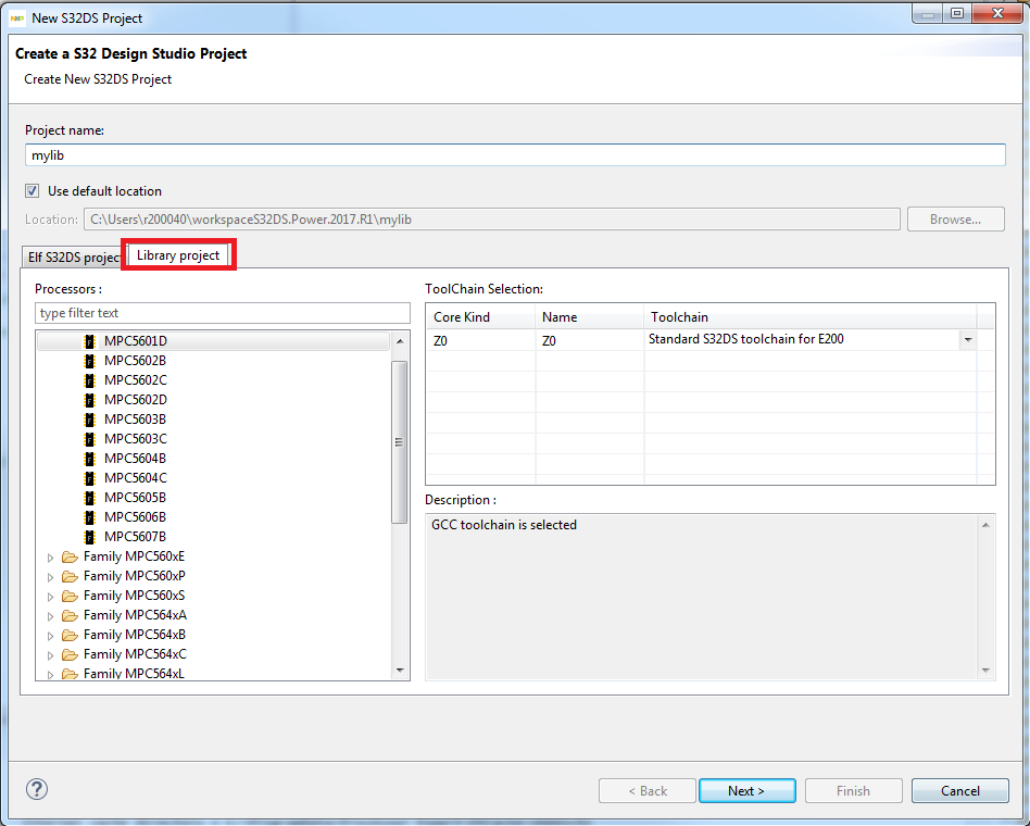

I assume you want to build the library from S32DS IDE.
The New project wizard allows you to chose between application or library:
Hope it helps.

stanish
Hope it helps.
