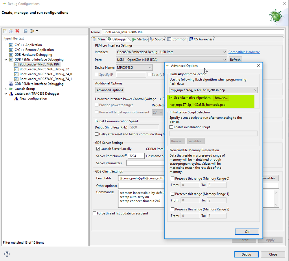

this topic has many info in the web yet  nothing help me to overcome this issue.
I'm using the DEV-KIT of mpc5748G chip and working on the bootLoader example, My first basic thing to do is to load this project RBF file into target and without any success.
i'm using the DEBUG-OPENSDA-E200_Pemicro_v110.SDA in  target (according to others answer in the web).
trying to drag & drop RBF file into target during bootLader mode doesn't work as well
Any idea what i'm missing ? is it S32 IDE issue or PEmicro driver/app ?

I figured out that you are using wrong programming algorithm. RappID bootloader is located in hsmcode flash part. You need to use alternative algorithm:
.pcp files are by default located in
c:\NXP\S32DS_Power_v2017.R1\eclipse\plugins\com.pemicro.debug.gdbjtag.ppc_1.8.3.201812312131\win32\gdi\P&E\
folder.
Hope it helps.
Jiri

Hi Jiri
you are great!
it works.
Thanks allot
