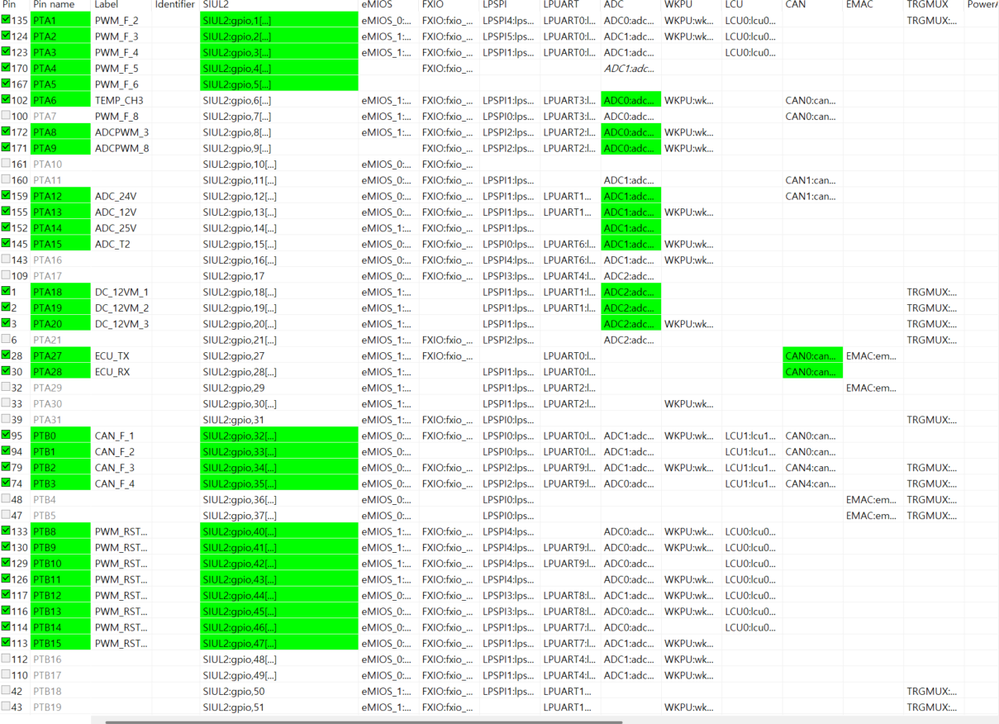

i will use pwm, adc, gpio, can, uart and so on..
and i assign pins.
after pin assign, do i have to add all of assign pins in port container?
if i don't add in port container and don't init port, that pins don't work??
thanks for regards.

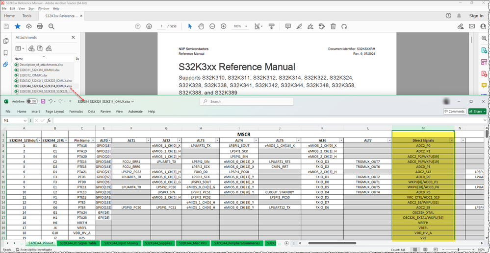

Yes.
* @brief Initializes the pins with the given configuration structure
* This function configures the pins with the options provided in the
* provided structure.
* @param[in] pinCount The number of configured pins in structure
* @param[in] config The configuration structure
* @return The status of the operation
Siul2_Port_Ip_PortStatusType Siul2_Port_Ip_Init(uint32 pinCount,
const Siul2_Port_Ip_PinSettingsConfig config[]);
Only those pins that have this function by default(Direct Signals) will work, such as ADC\CMP, etc.
