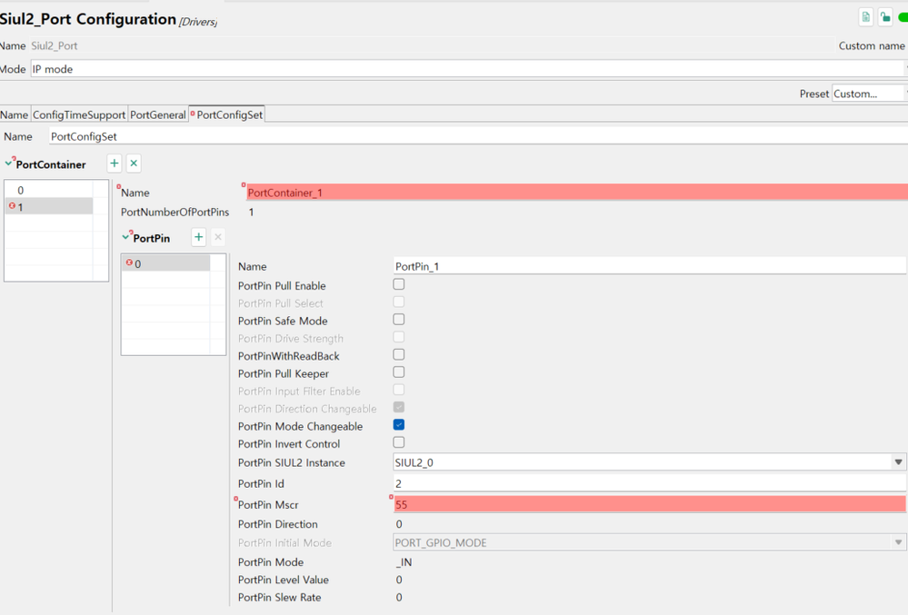

i wanna make each port container(adc, pwm, can, uart and so on)
but i got a error about functional Group.

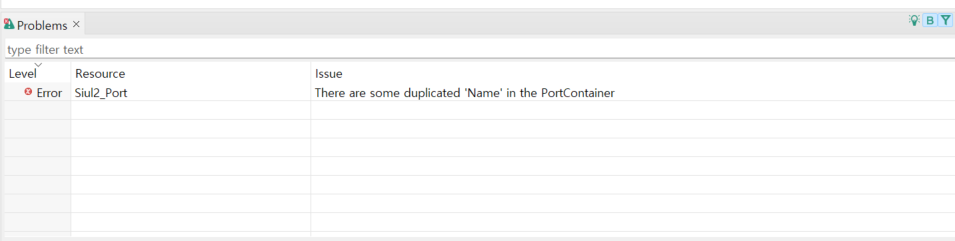

error is there are some duplicated 'NAME' in the PortContainer.
화면 캡처 2025-04-15 111945.png화면 캡처 2025-04-15 111958.png화면 캡처 2025-04-15 112628.png

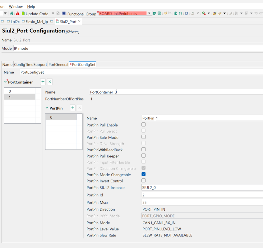

when i write a other PortContainer, portpin Mode, level value, slew Rate is not read. and i get errors.
1. is it imppssible for making multi portcontainer?
2. if it is possible, how it make that?
3. can i get codument or description for setting functional group and adding functional group?
thanks for regards.

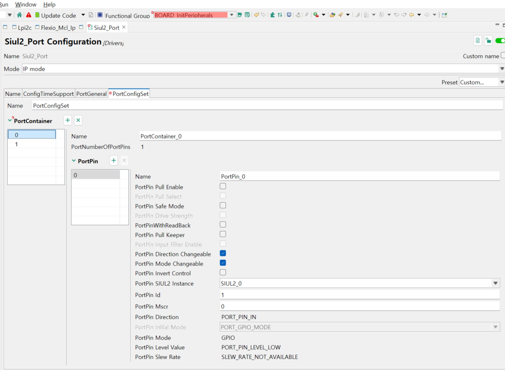

Please refer to the introduction in  Interacting with Digital Inputs/Outputs on MR-CANHUBK344
I have added the portpin id 1,2,3,4 in container 0.

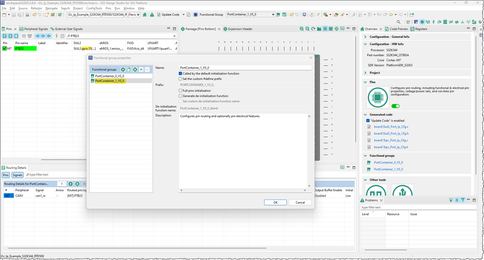

Robin_Shen
Did you add another PortContainer in Pins Tool?
PortContainer_1_VS_0 Pins Tool.pngPortContainer_0 PortContainer_1 Peripheral Tool.png
I'm not sure if this is what you need. If not please let me know.

i have questions.
1. what is mean portpin id//?
portpin id is 5 in your post.
@Robin_Shen
what is meaning portpin id is 5 in your pic?
does container 0 already has portpin id 1,2,3,4?
exactly i don't know portpin id's meaning.
is that just index?
2. if i have assign all of pin in one container, is it has a problem?
why s32ds has a continer? for managing pins???
