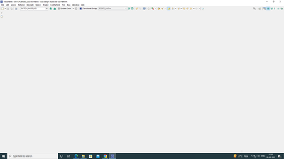

In S32DS, If I click open pins option in the ConfigTools, it is showing empty screen. Pins table is not opening.
How to get pins table?

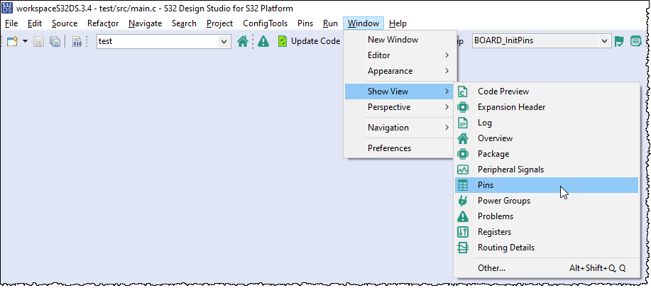

Please try to click Window->Show View->Pins

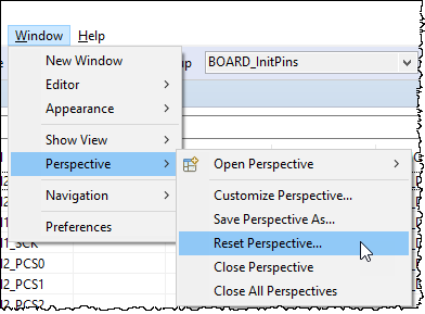

And Window->Perspective->Reset Perspective

SD14
It's working. Thank you...
