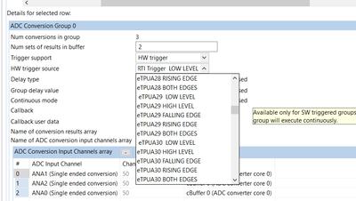

Hello everyone,
I want to configure ADC_PAL by selecting eTPUA28 as HW trigger source on MPC5775e. Could you share an example of ADC_PAL using HW trigger?
1,227 Views
davidtosenovjan
Hi, I don't have too much experience with this, but it seems configuration it quite straightforward.
The only example we have for it is following one:
adc_pal_eqadc_mpc5777c
