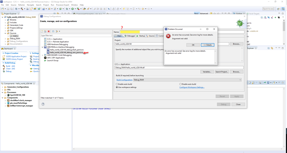

While debugging there is an issue called "An error has occurred. See error log for more details."

Previously I posted my query in below link
While debugging there is an issue called "An error... - NXP Community
After reinstall also facing same issue
I am working on urgent project quick response would be highly appreciated.

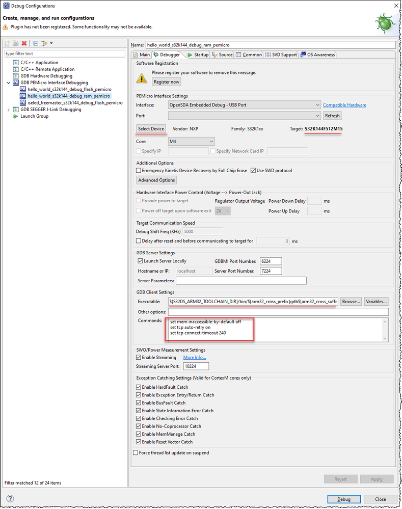

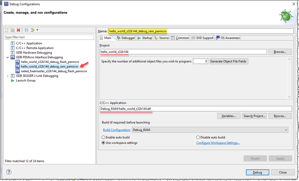

In the Debug Configurations dialog box, select the required debug configuration. The name of the debug configuration is composed of the project name, debugging interface and build configuration. The configuration settings appear on the tabs:
If I select hello_world_s32k144_debug_ram_pemico, the Name will shown in right side.
But don't know why the Name is blank at your side.
These configurations are set by default after selected.
