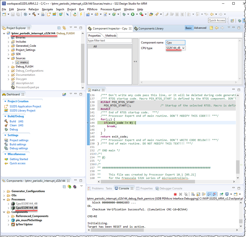

Robin_Shen
Hi senthilnathan_v,
Would you please let me know the version of your S32K SDK?
Processor Expert already supports 48 pin package in SDK RTM 3.0.0. (It should have been fixed in a later version too.)
Here you can see I change the CPU to 48 pins for lptmr_periodic_interrupt_s32k144 example.
It was able to work without clock issue.
