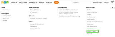

alejandro_e
Hello @Prathiksha,
As I mentioned it seems the installer for version 1.5.4 is no longer available, if you still have it, can you open a private support ticket and share the file with me?
Please add the link to this post and/or my name to the description of the ticket so we can ensure I keep helping you with this topic.
Thanks!

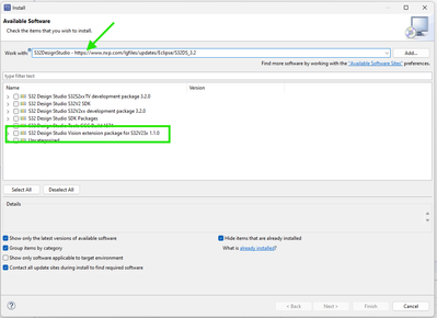

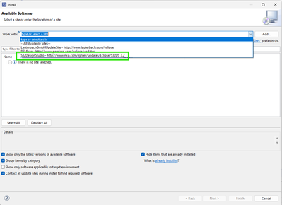

alejandro_e
Hello @Prathiksha,
I have received a solution to original question, sorry for the late reply. Please follow these steps:
- Open S32DS 3.2, click on Help, then on Install New Software...
- In the new window, select the S32 DS update site:
- This will give you an error, this is expected, now change the link from http://www.nxp.com/lgfiles/updates/Eclipse/S32DS_3.2 to https://www.nxp.com/lgfiles/updates/Eclipse/S32DS_3.2 (not the added s: in https). Now you will se the Vision Extension package:
I was able to install the package successfully following this steps, please let me know if you are able to follow them as well.
Thanks.
