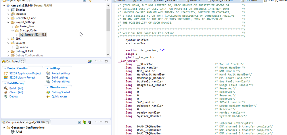

I am not able to locate vector table in any of the header files of the example application code of s32k144.
2,338 Views
jiri_kral
vector table is part of startup assembly code:
2,339 Views
jiri_kral
2,331 Views
6888
Got it! Thank you soo much!!
