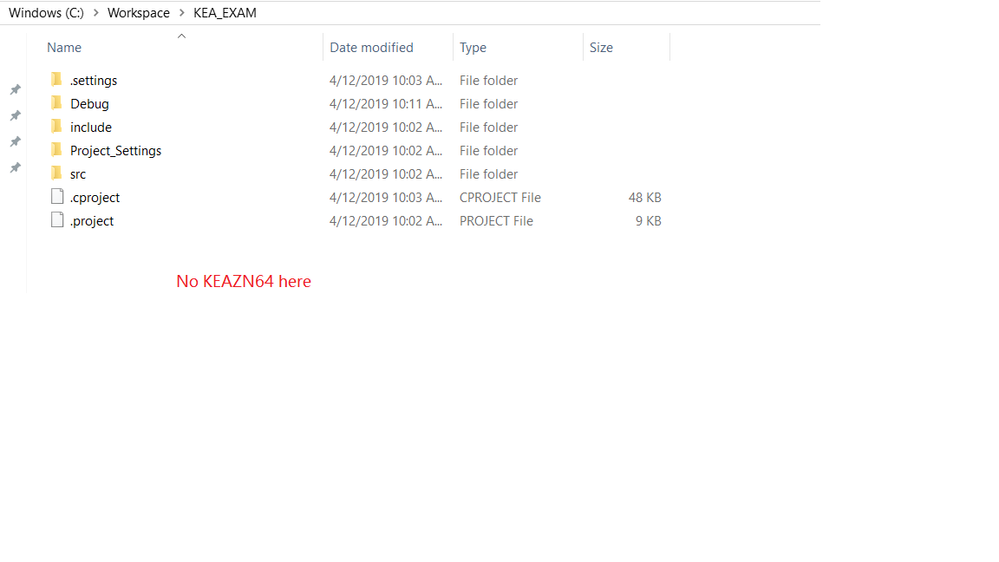

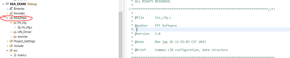

Hello, I use S32DS studio create a project for KEAZN64, and I see a auto generate virtual type folder #KEAZN64# in current directory, but I can't see it.
How can i open this folder and how can i view it in windows file system.

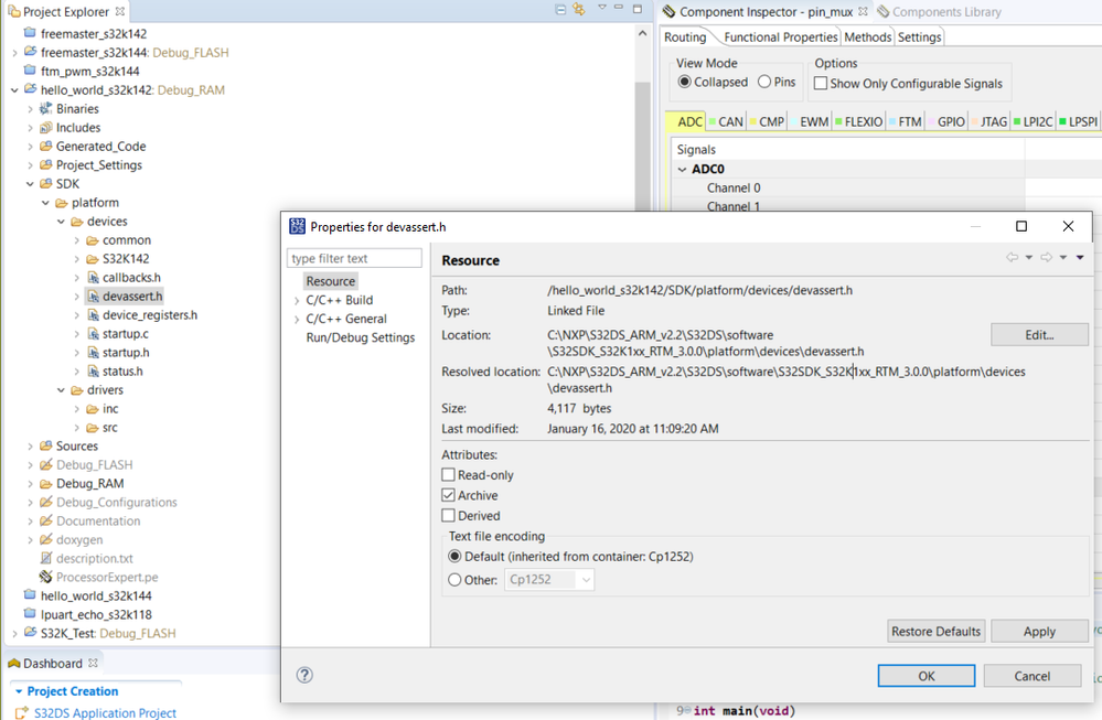

sanjay645
I am not able to see the path, please see this image and reply where is this path located, how to know that?

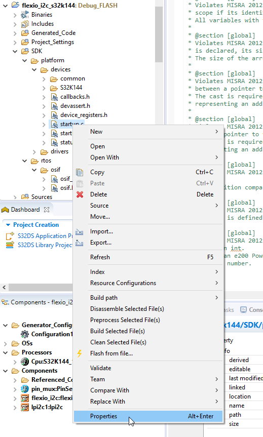

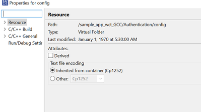

As S32DS for ARM used eclipse platform, which would use virtual folder for SDK. Virtual folder method uses virtual link to the actual folder location, which is not same as workspace. (i.e. It doesn't copy these SDK files to the workspace, instead it is just providing linkage. )

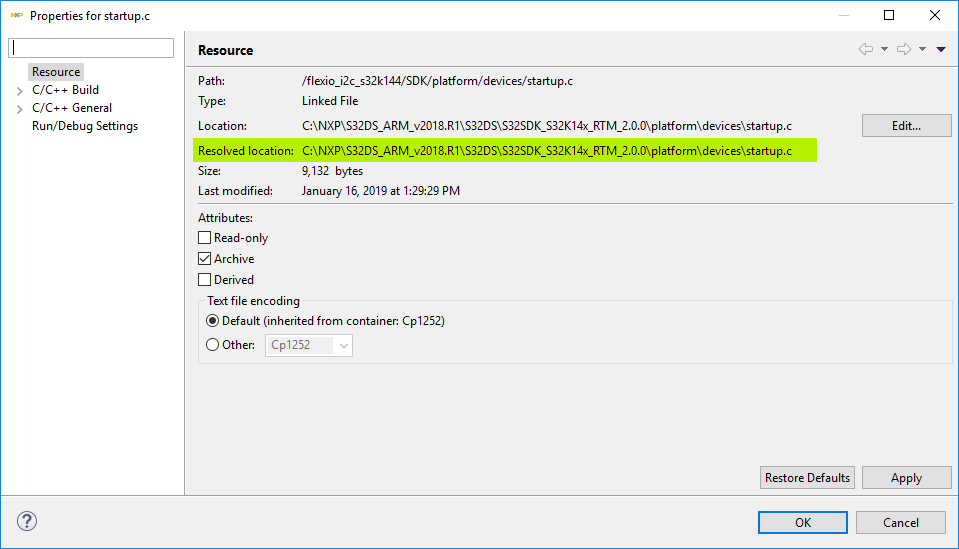

To check the path for this type of files you can right clock as shown in below image and select the properties option, which will provide you location and resolved location:

you can find real path to file by right click on file you are interested in -> properties:
and you can see real file path:
Jiri

Great! This problem confuse me for a long time,thank you so much!
