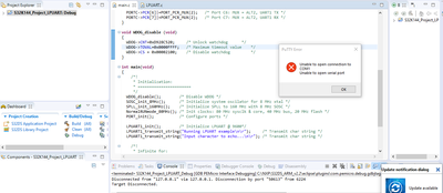

I am learning to connect S32K144EVB UART connection with putty terminal. I have used the exmple project. But not able to communicate. Pl see the attached  and help me solve.

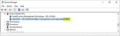

are you sure it's COM1?
Please check the port in Device Manager:
Your configuration in PUTTY should meet this.
