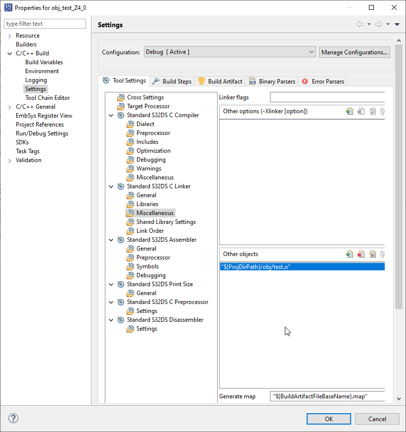

hello,I'm using S32DSPower Architecture Version 2.1 project compilation, before that I've been using static libraries".a" to package the program, but now I want to package the program directly using ".o" file, is it possible? If so, how do I do it? I look forward to hearing from you.

you can add an existing object file in project properties:
