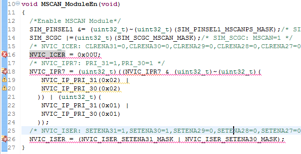

I'm trying to use the MSCAN_KEA_DEVD package in S32DS for a KEAZ128. I've copied the driver files and the code into my project and I get compile errors in MSCAN_Module.c. NVIC_ICER, NVIC_IPR7, and NVIC_ISER can not be resolved. I've copied the section of code causing the problem below.
I believe these are supposed to be enabling interrupts, but I do not see these show up in any documentation. I think maybe these have been depreciated, but wanted to pose the question here of what would be the appropriate replacement for this code?

Hello Thomas,
S32DS uses CMSIS functions for NVIC control in contrast to CodeWarrior "proprietary" header file NVIC macros.
I'd recommend you to replace NVIC macros with its CMSIS counterparts:
Attached is the entire S32DS project for your convenience.
[Updated] Fixed MSCAN IRQ Handlers (reported by 张三)
Stan

Hello Thomas,
Stan

张三san
hi,
in CW,the IRQ is
void MSCAN_Rx_IRQHandler(void)
void MSCAN_Tx_IRQHandler(void)
but in S32DS is
void MSCAN_RX_IRQHandler(void)
void MSCAN_TX_IRQHandler(void)
you can find it in startup_SKEAZ1284.s
so please change it in MSCAN_Module.c and MSCAN_Module.h
10,214 Views
stanish
Thanks for your comment.
I've fixed the example attached in my original answer.
Stan

thomasolenik
Stan,
Thanks. That was a big help.
Tom Olenik
