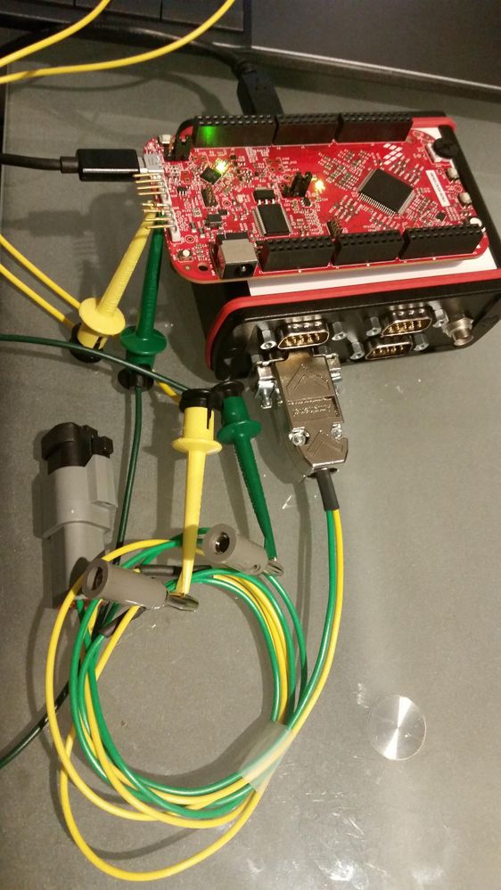

Stanislav, thank you very much for your support and for providing the project file. I couldn't see any transmitted messages on my Vector CANAlyzer (not even error frames due to bad baud rates), by any chance, do you know how I can calculate and change the baud rate to 250kbit/s?
I have another node that I can try putting on the same bus to see if It works. See picture of my CAN bus setup (equipped with terminating resistor)20170215_181757.jpg

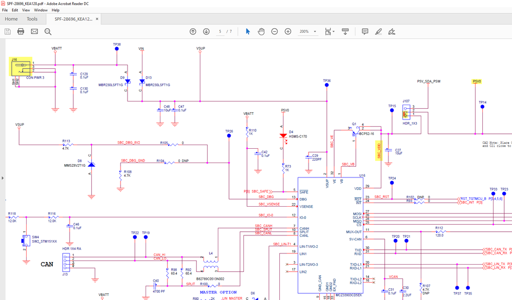

Hi Michael,
Sorry for the late reply!
You should connect Pin1 and Pin2 of J107 and then supply 12v power at J16.
Robin

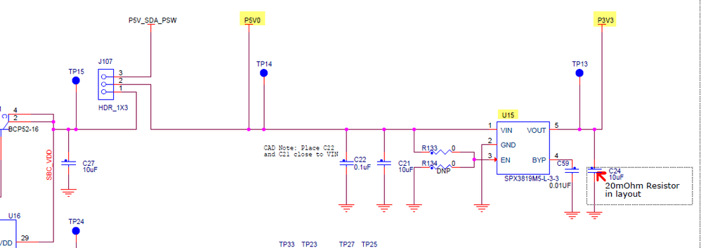

5,025 Views
Robin_Shen
Sorry for my delay!
Please check the FRDM-KEAZ128 Schematics.
If the D3 is off, then it mean there the P5V0 is not powered.
Have you modify the hardware of FRDM-KEAZ128 (for example: R63 or J10)?  The default hardware use P5V0 power MCU, it didn't use P3V3 power(voltage alimentation U15?) it.
