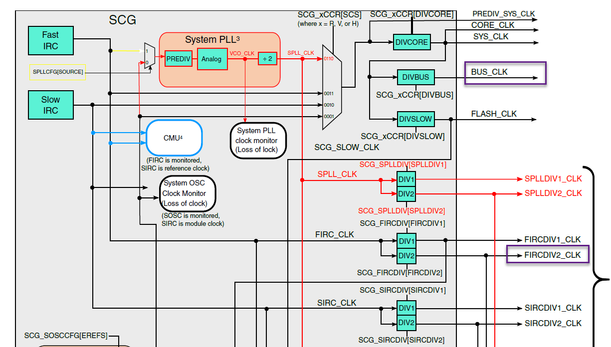

danielmartynek
Hi Paola,
fFIRC is 48MHz,
fFIRCDIV2 is configurable:
fADCK id then fFIRCDIV2 / ADIV
Max fADCK is 50MHz but it must not be > than fBUS_CLK.
fBUS_CLK is fCORE_CLK / DIVBUS

2,814件の閲覧回数
danielmartynek
Hi Paola,
This seems to be correct.
But you can always verify the clock by scoping the BUS_CLK on a CLKOUT pin.

Daniel sorry for my trivial question but I would ask you the following thing:
if I select as the clock of ADC FIRCDVI2 [PCC->PCCn[PCC_ADC0_INDEX] |= PCC_PCCn_PCS(3)], it is necessary to set the slow run mode in order to obtain as the core_clk and the bus_clk 48MHz.
In term of conversion time of ADC, this means that the fADC and fBUS is equal to 48MHz. Is it correct?
Thank you
