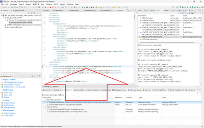

Unknown referenced nature: com.freescale.processorexpert.core.expertprojectnature.
2,175件の閲覧回数
CY9
S32DS-S32PLATFORM
S32D v3.5
uC: S32K144
Compile: adc_pal_s32k144 example + FreeMASTER SDK
Any suggestions?
Should I remove these lines?
or ??

Robin_Shen
It is recommended to install S32K1 RTD 2.0.x with S32DS Extensions and Updates in S32DS v3.5.  If the online installation fails, please refer to HOWTO: offline install S32K1 RTD 2.0.0 in S32DS v3.5
Or install S32K1 SDK RTM 4.0.3 with S32DS Extensions and Updates in S32DS v3.4.
It is not recommended to install S32K1 SDK 4.0.x in S32DS v3.5. According to the currently available information, we don’t have any plan to integrate S32SDK S32K1XX 4.0.x into S32DS 3.5 or above version.
I imported adc_pal_s32k144 of SDK 4.0.3 in S32DS v3.4 and did not encounter this warning. It seems that this problem has been fixed in the latest SDK version.
