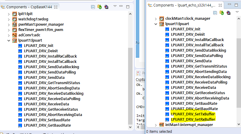

I implementted LPUART function with S32KDS and SKD_S32K14x_09.
But the UART function does not work.
I attched my project.
Please review my project.

I looked at you project and question is - how do you find out that UART doesn't work? In your project is only UART init function - returning STATUS_SUCCESS.
Please look at lpuart_echo_s32k144 example for reference:
Hope it helps.
Jiri

1. How to get the S32K14x_RTM_SDK_V2.0.0?
2. How to use UART interrupt?
    I use LPUART_DRV_InstallRxCallback. But I think Interrupt does not be clear.
    Can you give me the guide of interrupt of uart?

You can click on this message box - probably appeared after S32DS Launch to update S32DS:
If you don't see such message - update your S32DS Installation manually  - on main menu bar click on Help -> Install new software
Click on available sites, choose PEMicro and S32DesignStudio, click on OK
In Work with row select All Available sites - and when updates will be found - click on next.
As I mentioned above - best starting point is LPUART echo example - this example is available in any SDK version and uses interrupts.
Hope it helps
Jiri

1. How to import S32K14x_RTM_SDK_V2.0.0?
    I get the samplecode with S32K14x_RTM_SDK_V2.0.0.
    But I don't use S32K14x_RTM_SDK_V2.0.0.
    So I don't use some funtions.
2. How to clear UART interrupt?
    When I test send uart message of very big data size.
    Because interrupt does not clear, MCU is reset  because of watchdog time out.
Byungju.
