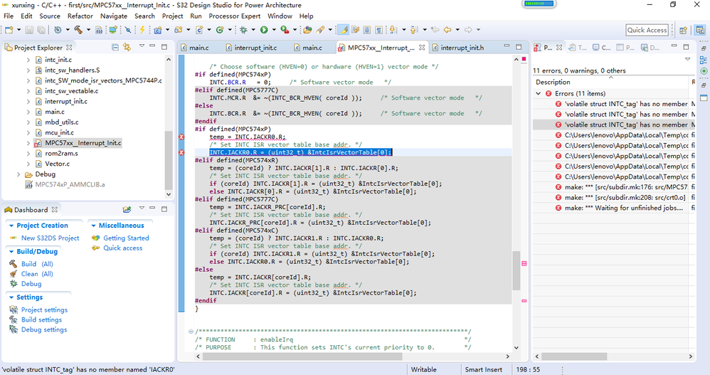

I in matable MBD toolbox generates a about mpc5744p single-chip computer code, but I can't put these code successful import S32 development environment, in the process of generating code, I have the target compilers chose S32, but manually import the generated code file will still be a mistakeQQ截图20180718085713.png

in my opinion you are facing standard C issues - like missing headers, missing path to headers and So on. Just make sure that you have set all include paths correctly and project contains all necessary headers.
