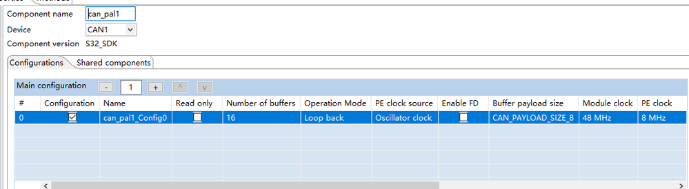

    Recently, I came into contact with S32K platform. The loopback test using CAN_PAL peripheral failed. It has been several days.Please give me a suggestion.The code is simple, as follows:
  •     In DEBUG, the program gets stuck in "while(CAN_GetTransferStatus(&can_pal1_instance, RX_MAILBOX) == STATUS_BUSY);
CAN_PALCAN_PALPIN_MUXPIN_MUX

PetrS
try to move CAN_ConfigTxBuff into main function. But rather reorganize code little bit, e.g as below

RyzeBai
Thanks for your advice! I achieved it after move CAN_ConfigTxBuff into main function!
But I don't understand why.can you tell me? thanks a lot.
