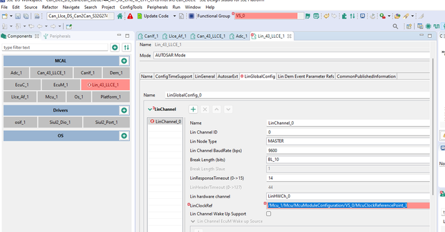

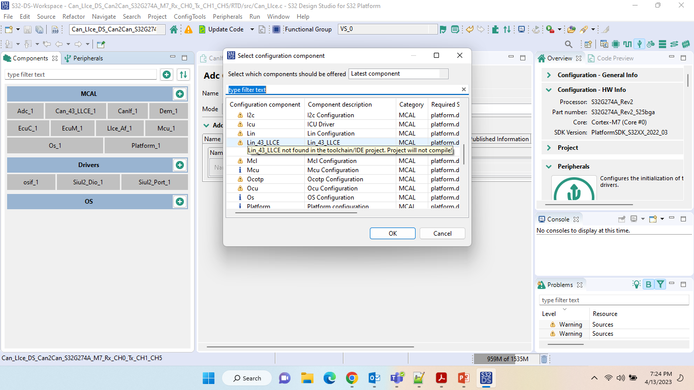

I am Working LIN- project. Adding LIN-43-LLCE in MCAL. This i am adding in CAN2CAN project which NXP LLCE example project:
How to add LIN-43-LLCE which is already added with LLCE-1.0.4.
How to added clock reference :

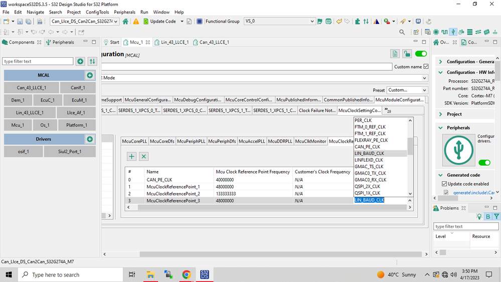

To add clock reference change Mcu Clock Frequency Select as LIN_BAUD_CLK. to change this go to Mcu_1 component  and change Mcu_1 -> McuModuleConfiguration  -> McuColckSettingConfig ->  McuClockReferencePoint. set McuClockReferencePoint_3 as LIN_BAUD_CLK.

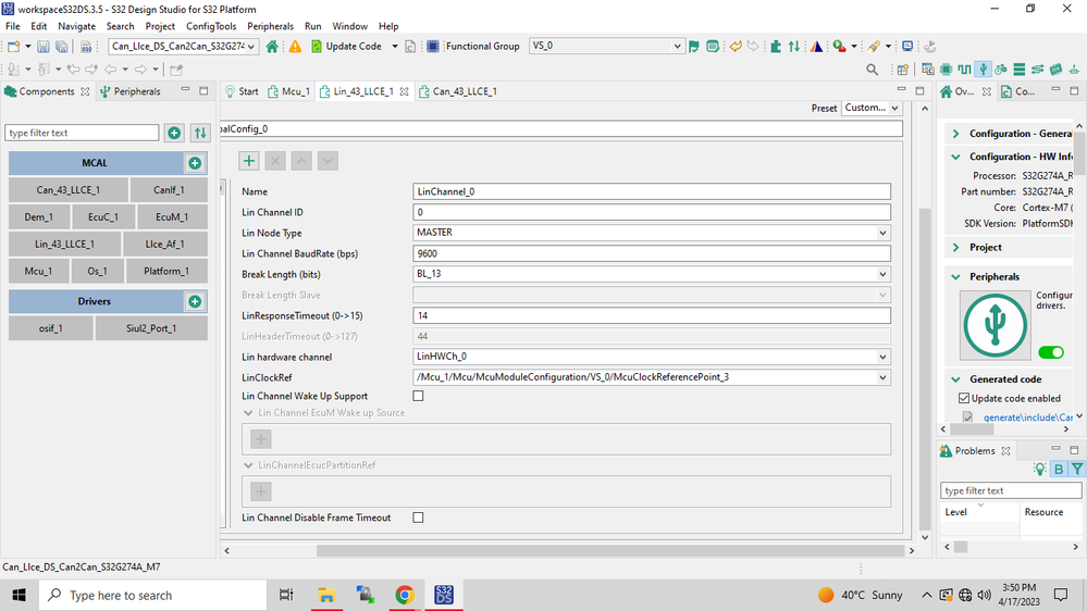

now you will see clock reference error has been resolved .
