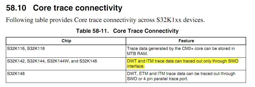

in s32kxx RM, page 2143, there is a table which says DWT in s32k142 can not be access by user application.
so, for each function we can not use this unit in runtime.
is there any document from NXP which give SDK function times? or we should measure them in debug mode and consider that in run time application?

JeorgeB
unfortunately I have not access to board yet and want to know is true my opinion about DWT? (it is not possible to use DWT in run time application by CPU).
Thanks.
2,565 Views
Robin_Shen
see how to use it directly from the application code: Cycle Counting on ARM Cortex-M with DWT
