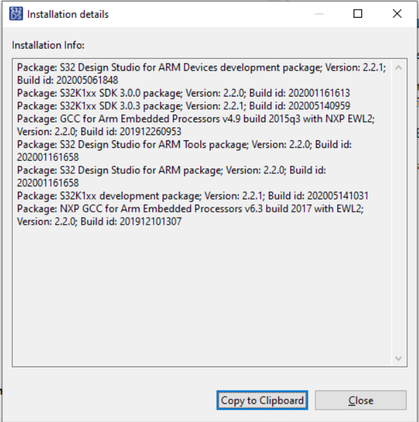

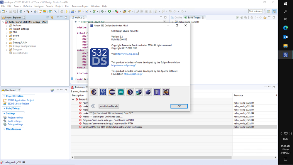

I installed S32DS and tried the hello world example for s32k144 but failed with this information.
Not sure if there is something wrong with the example code or with the S32DS settings.
Does anyone have a clue of this issue?
Thanks.
S32DS versionS32DS version
Installation detailsInstallation details

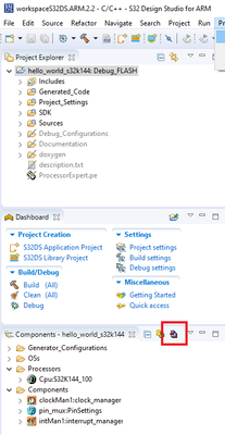

Since I did not see the 'Generated_Code' folder listed in the Project Explorer view, this was not done so some of the needed files are not existing in your project, causing the build failure.

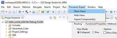

To resolve this, select Show Views from the Processor Expert menu in the toolbar.
Next, select 'Generate Processor Expert Code' from the Components view.
The code should then be generated into the Generated_Code folder and then you should be able to try the build again.

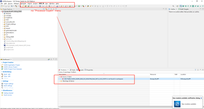

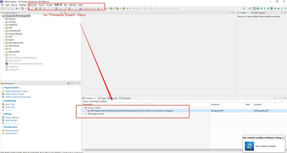

FengDuoLi
how to deal with it?
