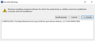

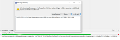

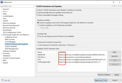

I try to install SW32k3 development package from SW32K3_S32M27x_RTD_R21-11_5.0.0_D2410_DesignStudio_updatesite(help-install newsoftware),and the  warning below will always pop up:

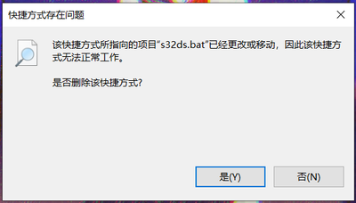

then i click"install anyway".The S32 DS IDE will close itself. When i tried to start it again, i found that the s32ds.exe file under "eclipse" is missing and i have to re-install S32DS v3.5
I also tried to update IDE with SW32K3_S32DS_3.5.13_D2407,still not working
Can anyboby help me with this issue?

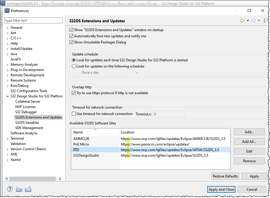

Robin_Shen
On some machines doesn't work repositories with http:// - please try to change http:// to https://

ErinYu
thanks a lot for your reply, i have change it as below:

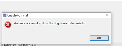

but still not working. I tried to update the packages below, but the IDE close itself again with this pop up:

Robin_Shen
Have you tried to install S32K3 RTD 5.0.0 offline? Please refer to: HOWTO: offline install S32K3 RTD 4.0.0 in S32DS v3.5
1. Install S32Design Studio 3.5: S32DS.3.5_b220726_win32.x86_64.exe
2. Install Update 13 for S32DS: SW32_S32DS_3.5.13_D2407.zip
3. Install development package for S32K3XX: SW32K3_S32DS_3.5.13_D2407
4. Install development package for S32K396: SW32K39x_S32DS_3.5.13_D2407.zip
5. Install development package for S32M276: SW32M2_S32DS_3.5.13_D2407
6. Install updatesite for this release: SW32K3_S32M27x_RTD_R21-11_5.0.0_D2410_DesignStudio_updatesite.
zip

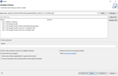

ErinYu
Please refer to the screenshot below:

ErinYu
Yes i tried. I tried install SW32_S32DS_3.5.13_D2407.zip but the progress stuck at 80% and the software closed itself again and s32ds.exe missed just as before
