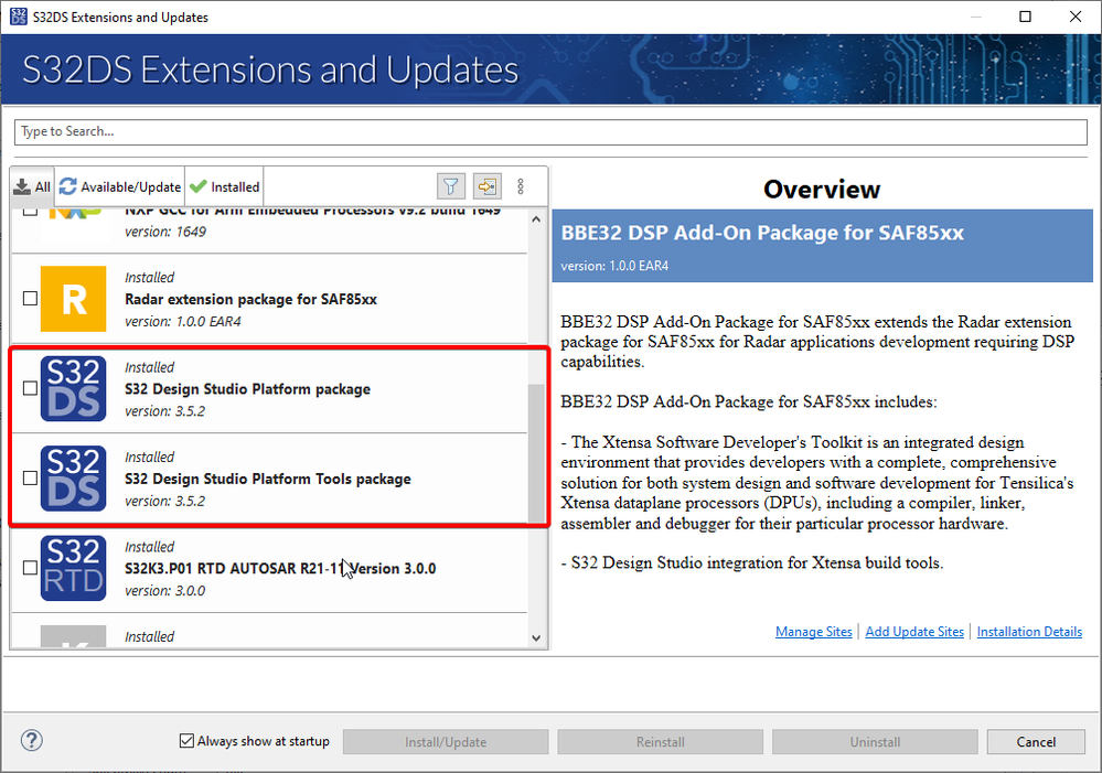

We are using the S32K3X4EVB-T172 Evaluation Board and We are trying to load the example file in the EVK board..
I installed S32 Design studio 3.5, S32K3xx development package (SW32K3xx_S32DS_3.5.0_D2303.zip).
After that I tried to install the RTD files(SW32K3_RTD_4.4_R21-11_3.0.0_D2303_DS_updatesite.zip) But im facing the below issue.
Operation details Software being installed: com.nxp.RTD.S32K3XX.root.feature.feature.group 3.0.0.202303311831 Missing requirement: com.nxp.RTD.S32K3XX.root.feature.feature.group 3.0.0.202303311831 requires 'org.eclipse.equinox.p2.iu; com.nxp.s32ds.platform.ide.feature.feature.group 3.5.1' but it could not be found
After the S32K3xx development package installation im able to create a new project for S32K344 but im unable to open any example files.
Please help me to solve this issue.

jiri_kral
please make sure that you updated S32 Design Studio Platform Package and S32 Design Studion Platform Tools Package to latest vesion:

Vignesh_S
Thanks. Issue is resolved after installing the correct development package.
