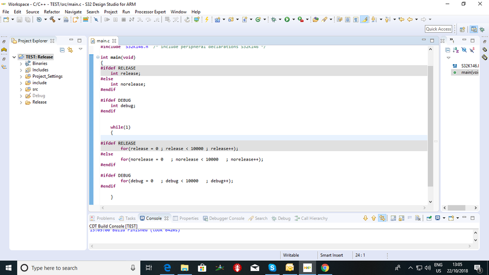

I am using S32 Design Studio for ARM Version 2018.R1  , for my project . I have selected s32k146 as my target .
And my test code is like below
But defining RELEASE as pre-processor has no effect , code within  RELEASE define is not taking into account for compilation .
Their is one more issue if i use preprocesor directive DEBUG , in debug mode configuration , then in release mode it is also taking into account .
I think this is somekind of bug in s32 studio  .  Please help in fixing this issue .
I am attaching my workspace , as attachment , make build configuration as RELEASE after importing project as it would be in debug by default .
Any help would be appreciated .

Hi.
thank you for report. It looks that only macros for very first configuration are used (debug in your case). Macros for other configurations are ignored. I'll rise ticket for this bug. Thanks again.
Jiri

claudio_b
I have the same problem with Version: 2.1 Build id: 190624 . How can I solve it?
