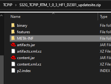

Daniel-Aguirre
The link you have shared redirects to the S32K1 Reference Manual.
You are talking about a *.zip file, we assume since TCPIP is provided as an *updatesite.zip file, but this file is used as an installation package, not for it to contain any source files:
Do you import this example from someone else? Or did you import it directly? Can you help us sharing the Installation Details of you S32DS setup?
Please, let us know.

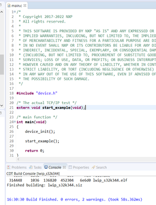

Daniel-Aguirre
Thanks for your feedback. We were mistaking the *.zip file you were talking about, we apologize.
Still, have you modified anything inside the project or generated any code? The example is provided for it to be imported and compiled, there is no need of generating any code, since it already has it integrated. We have used the link you have provided and we are able to compile it:
If you want to modify it, then the TCPIP/RTD/FreeRTOS will be needed. We can recommend looking into the S32K3 Automotive Telematics Box (T-Box) lwIP Example Guide Training Presentation (nxp.com), since it provides the expected way of handling the different examples.
