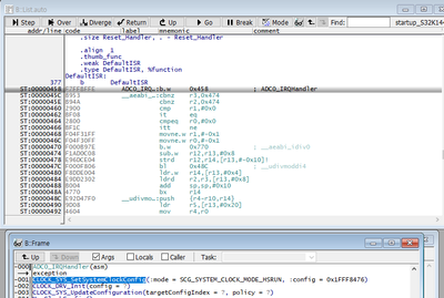

hello, NXP Team.
i'm using the S32k144 it's components repositoy SDK_S32k144_15.
I ran into a problem after deleting and adding a project from the same source in S32 Design studio.
As a result of debugging with T32, a hard fault occurred in DefaultISR (ADC0_IRQ),
but I do not know the reason.

i'm solved it.
clock re setting and gencode after solved.

I also encountered this problem, jump directly to
DefaultISR:
b DefaultISR .
What is the meaning of clock reconfiguration ? thank you for your help.

Have a look at Fault handling on S32K14x, check which exception occurred and the address that caused it.
Please tell me the version of S32DS for ARM(2018.R1 or 2.2)? The version of S32K1xx SDK(3.0.0 or 3.0.2 or 3.0.3)
Please send me a screenshot of the S32DS debugging interface when the step debugging fault occurs.
Robin

1. address ST:0x458 / symbolic : ADC0_IRQHandler is C code (startup_S32K144.S)
2. S32K144_SDK Version ( 3.0.0) / S32K144_AMMCLIB (1.1.20) Use...
3. Debug program T32 is in use.
thank you.

i'm solved it.
