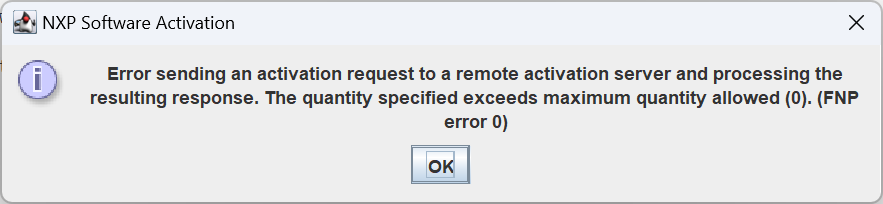

I have re-installed the S32K3 Design Studio 3.5 (using S32DS.3.5_b220726_win32.x86_64.exe) in my notebook and encountered activation issue as below. The installation could not complete after the message had popped up. My notebook is with Windows 11. Tried both online & offline activation.
It happened after I had un-installed the S32K3 Design Studio v3.5 and re-installed it in the same machine.
I would like to know if any way to fix it.
Thank you.

I am not sure why, but as I see, you had only 1 license was already used, so you were no longer able to raise request for the activation. I have increase license quantity to 100, so 99 licenses are available now.
Please can you check whether you are able to use the license or not. If any issue please let us know.

The installation process can now be completed and the problem has been fixed.
