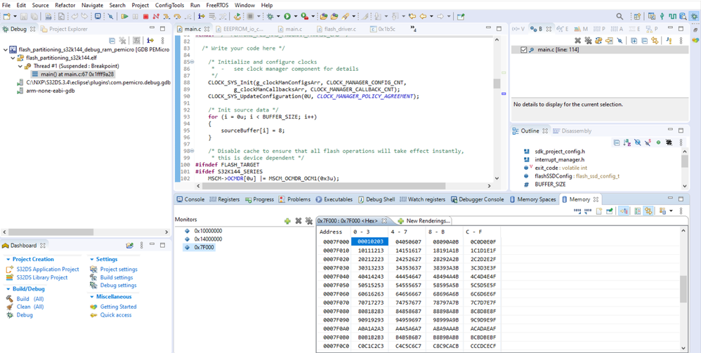

Hello Team,
EEPROM Partitioning is required for our project so, I am trying to run Flash Partitioning example code on S32K144 EVB with S32DS 3.4 having 4.0.2 RTM.
My Observations:
1. The values written in P-Flash(0x7F000) as well as EEPROM(0x14000000) is same as the source buffer (0-255) which is how the example code is expected to work, after reset i can see the same values in the respected memory sections.
2. I then updated the source buffer[i] = 8 to verify if P-Flash and EEPROM are getting updated with new values. During runtime i see that the values were updated in memory, then i tried to reset the board and checked for the values but i saw the values as per point 1(which is 0-255) being updated rather than the value in source buffer(which is 8).
As per my understanding from AN11893, once the EEPROM memory is updated, there will be an internal statemachine that invokes a write to Backup EEPROM. According to this point i assume that write to EEPROM backup did not work since its always retaining the value from first scenario. Please look into the below images from my testing Memory_1.PNGMemory_1.PNGMemory_1_after_reset.PNGMemory_1_after_reset.PNGMemory_2.PNGMemory_2.PNGMemory_2_after_reset.PNGMemory_2_after_reset.PNGCan you please let me know what i am missing to get this code working?

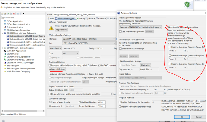

2. Every time you debug, it will erase the data in the backup area by default.
You can protect the partition through the following options

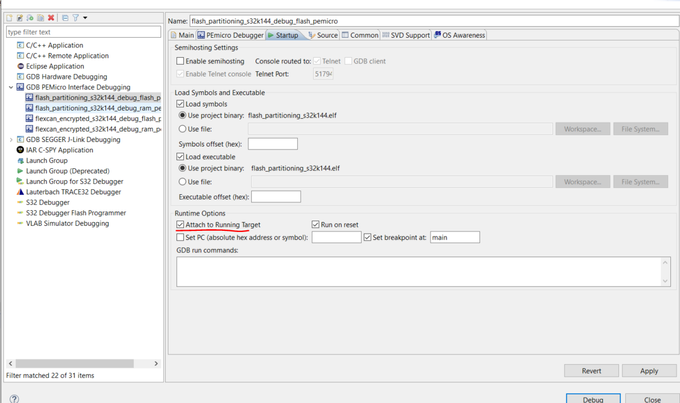

3. Debug the code by "attach".
This options will not erase the program and data in the current MCU,this is very useful in some conditions

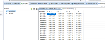

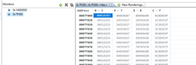

These values stays in back up and never get changed. even though i update the source buffer with differ values, write to pflash and eeprom. after power cycle I expect to see updated values to be stored from eeprom backup but i see 00,01,02....FF in both pflash and eeprom.
I just want to understand how to initiate eeprom backup properly and how to erase the already written values in both locations.
once written to eeprom backup, can't we update with new values? because I am running the same code by changing the source buffer values but after reset I see older values.

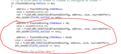

I tried to update the other locations in eeprom, which is working, see image below
but not on the locations which was there in original code. I still see older values, see image below
