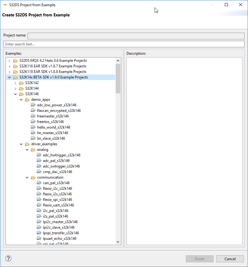

It looks that the only hello world example available in S32 Studio for the S32K146 is only for the 144 package. Is this correct? or I'm missing something? How can I change the configuration for the 100 packaging?

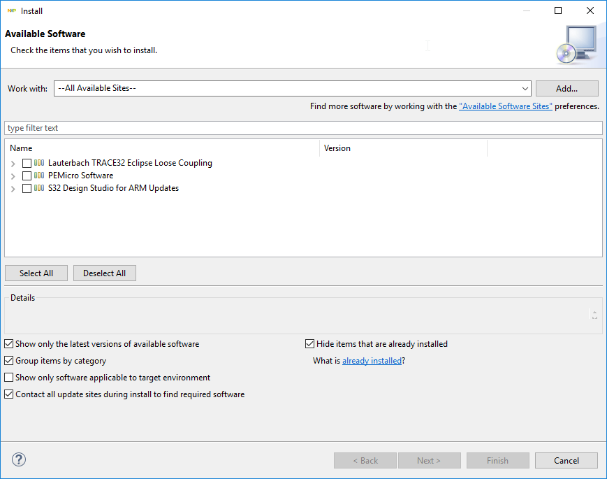

jiri_kral
correct - in EAR SDK v0.8.6 is only one S32K146 example. You can use S32K14x Beta SDK v1.9.0 instead - there is full set of examples present:
The Beta SDK is part of S32DS update. On main menu bar click on Help -> Install new Software choose all available sites, check what you like to update and pres next button:
