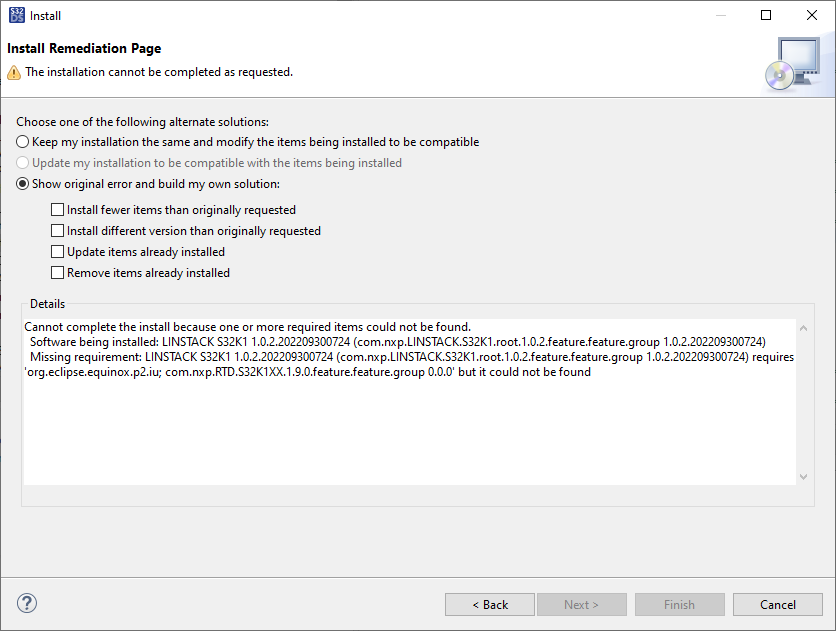

I'm trying to move our projects from S32 SDK to RTD. S32K116/144/148 are used in our projects.
I installed the following software:
S32DS 3.5
S32K1xx development package 3.5.0
S32K1 RTD AUTOSAR 4.4 Version 1.0.1 HotFix 01

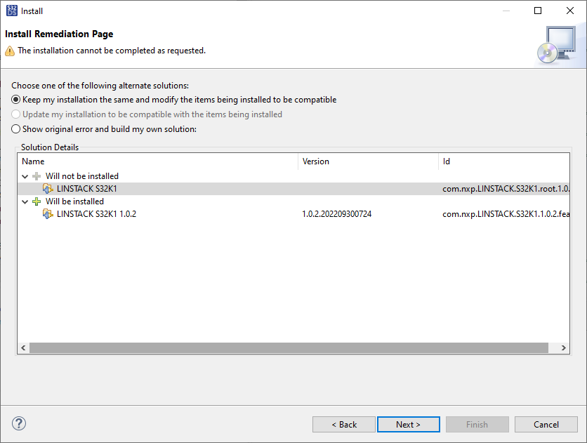

And tried to install the lin stack with S32K1_LINSTACK_RTM_1_0_2_CD01_D2209.zip but failed:
Screenshot 2023-07-13 113541.pngScreenshot 2023-07-13 113541.pngScreenshot 2023-07-13 113611.pngScreenshot 2023-07-13 113611.png
From this thread it seems the lin stack 1.0.1 is needed.
The problem is, I cannot find the lin stack version 1.0.1
Please someone from NXP could let me know how to fix this issue. Thanks!

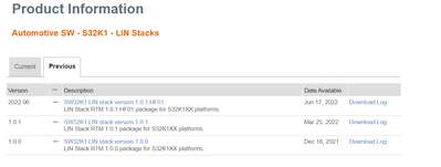

You can download it from our website at S32K1 Reference Software -> Automotive SW - S32K1 - LIN Stacks -> Previous tab.

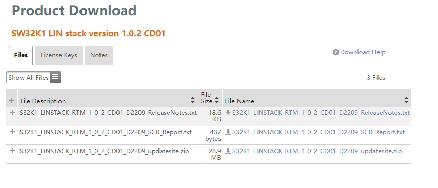

8,442件の閲覧回数
ke
Hi @VaneB
the Previous tab is not available.

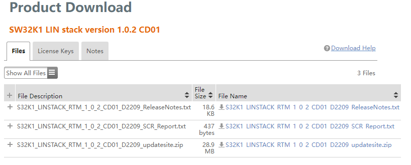

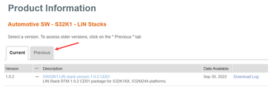

VaneB
Hi @ke
The reason for this is that when you enter Automotive SW - S32K1 Reference Software -> Automotive SW - S32K1 - LIN Stacks, you click the SW32K1 LIN stack version 1.0.2 CD01. Once there, you do not see the previous tab. What you need to do is not click SW32K1 LIN stack version 1.0.2 CD01.
Please refer following image.
