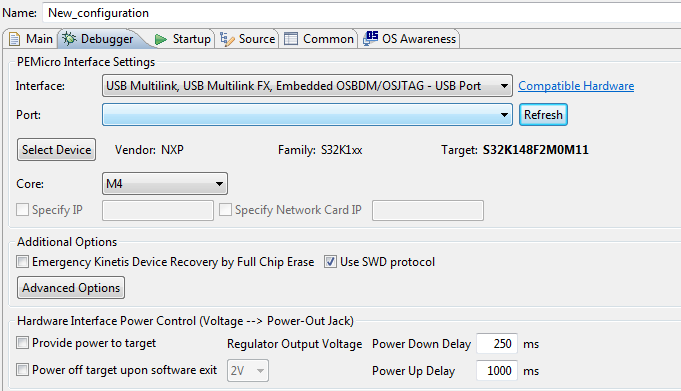

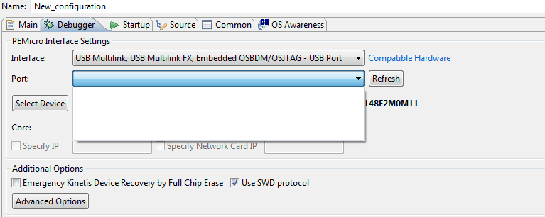

I have Multilink Universal  FX debugger for S32K148. It gets found on my Linux Ubuntu host.
When I try to use the same debugger on Windows 7 virtual machine with Linux Ubuntu host, the debugger is not found and "Port" in debugger setting in DS is empty even when I click "Refresh".
The debugger is connected to the virtual machine, I can also see it in Windows Device Manager under "Jungo Connectivity".
What am I missing?

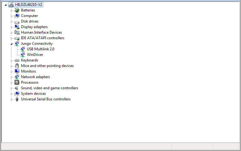

The debugger appears in windows device manager under jungo connectivity:
Any clues?

jakub_mielczare
Hi Jiri,
I re-installed the driver from PEmicro | Experts in Embedded tools for Flash Programming and Development USB Multilink Universal (and FX) Resource CD". The version of USB Multilink 2.0 driver is 12.7.0.0, the version of WinDriver is 11.7.0.0.
S32DS still does not detect the device.

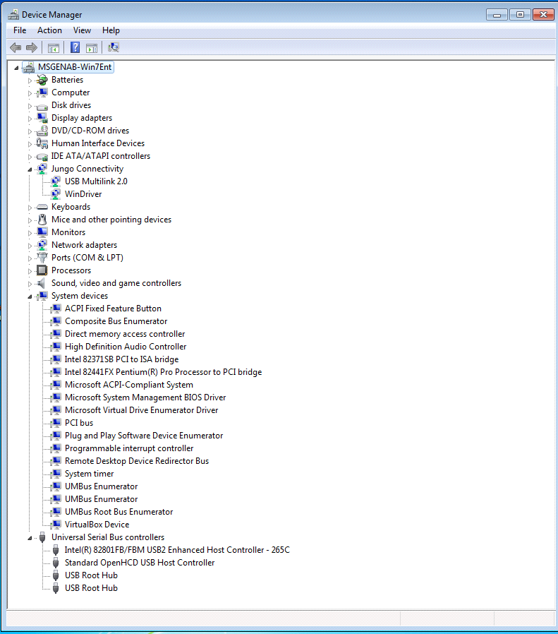

So, on my side it is working okay. I used fresh Windows 7 64bit installation and Installed S32DS ARM v2018.R1 with default settings - that's all.

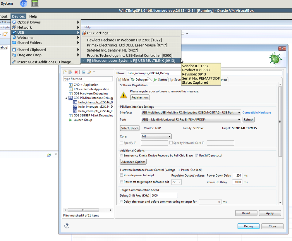

Here is USB settings:
and screenshot from device manager:
What about other USB devices - like Flash disks - are they usable in Win 7?
Jiri

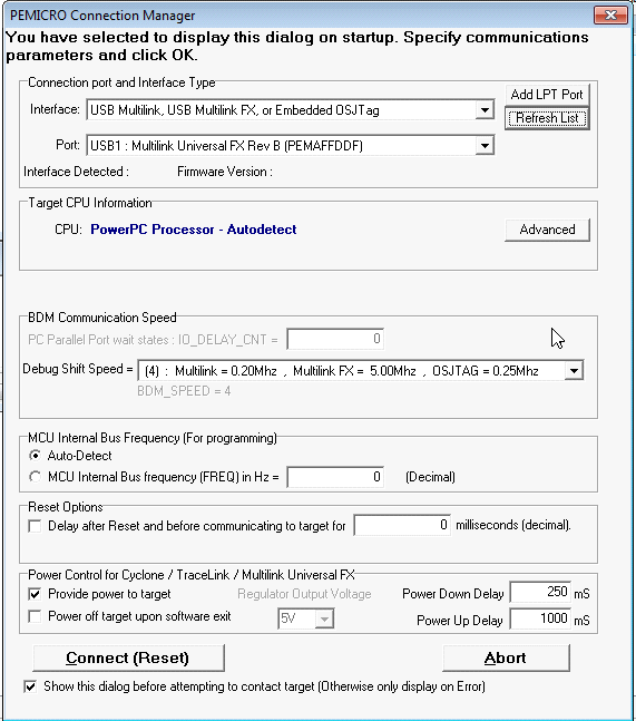

Well - I'm lost. Can you share output from lsusb -v for Multilink FX (in attachment is output from my machine). Anyway -
Did you tried your Multilink probe with S32DS (version for Linux)  installed on your Linux host?
So - the last thing what you can try is if the issue is with S32DS itself or with the PE Micro driver.
You can install for example PE Micro PPCNEXUS flash tool from here - http://www.pemicro.com/downloads/download_file.cfm?download_id=194
and try if Multilink FX is visible for this tool:

I'm trying reproduce your issue with Win7. I had no issue with Win10 running in VirtualBox on Ubuntu.
My configuration is Ubuntu 16.04 LTS and Oracle Virtual Box - 5.0.40 . If I remember it correctly - I had some issues with VBox from Ubuntu repository related to Extension pack - that's why I installed Oracle version. You can give it a chance - this is repo source from sources.list:
"deb https://download.virtualbox.org/virtualbox/debian xenial contrib non-free"
Jiri
