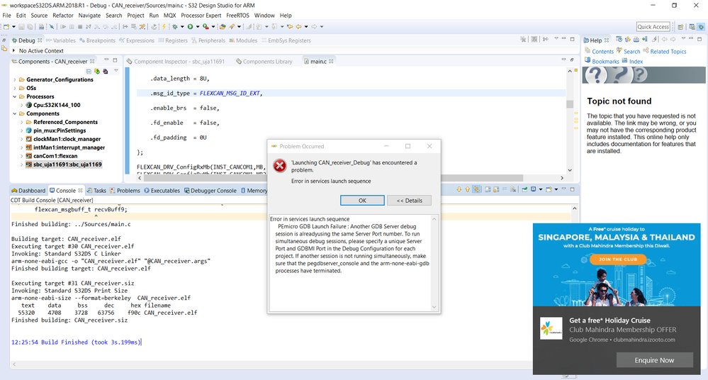

I'm facing this issue; where I'm not able to debug any project (getting the following error- attached) PDB- Launch Failure. Kindly help with this asap.

there is probably another pegdbserver_console instance running ( as error message suggested). Start windows task manager, check if there is pegdbserver_console running. If yes, just end pegdbserver_console task:
