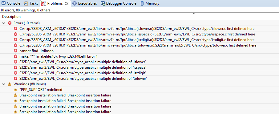

I am using a custom S32K148 . I want to debug my application using Debug Console. How would I do it. Kindly, help me with it.

saad_saeed
Thankyou Martin,
Yes I tried it but problem is I am not using UART. I am programming using JTAG.
However, I did followed what was mentioned in the post and I got the following errors

martin_kovar
please add -z muldef linker option into your project. Please see the thread below:
https://community.nxp.com/message/1020884?commentID=1020884#comment-1020884
Hope this resolve the issue.
