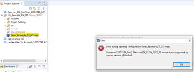

Hi Sir or Madam,
I installed necessary packages into S32DS, and imported some example projects.
Some projects can be installed into my environment, but the .mek file for Configuration Tool cannot be opened.
This issue appears to depend on PlatformSDK version, but I couldn't understand the version dependence.
Would you tell me the how to solve this issue?
I would also like to know about the Version dependency with PlatformSDK.

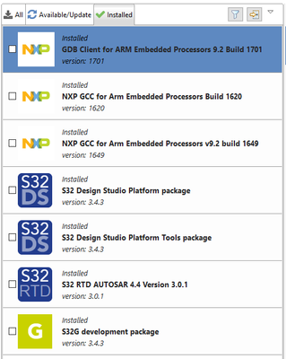

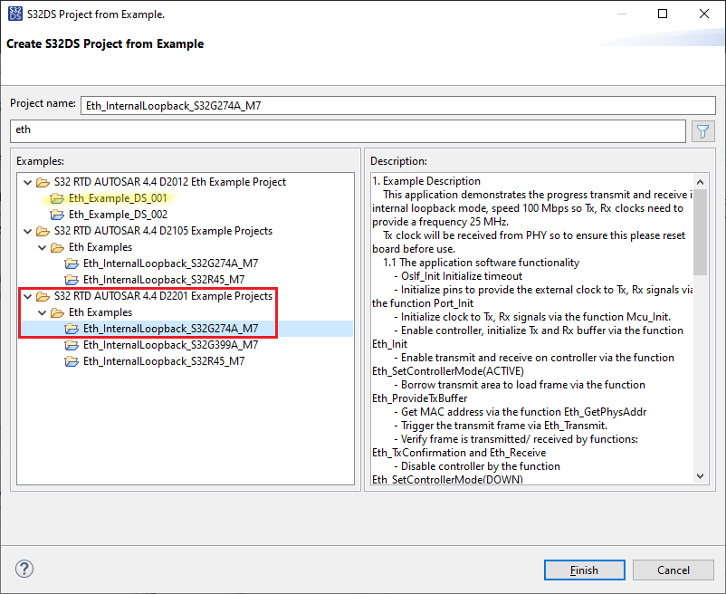

Hello Keita,
It seems this project is quite old and was created for the RTD which was released in December 2020. I suggest you use the new version which was included in the updated RTD you installed.
Mike

Keita_Nagashima
@mikedoidge ,
Thank you for your reply. I understood it.
BTW, do you know how to delete the old project like December 2020 version?
I'd like to manage the all project.
Keita

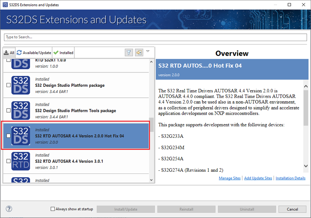

Hi @mikedoidge ,
Please refer to the figure in my original message. I have already deleted the old RTD and my environment was not seen it.
But, the old version of the sample programs are still there...
Keita
6,467 Views
mikedoidge
If the old version of the RTD was uninstalled from S32 Design Studio, then the associated example projects should be removed as part of that process.
Perhaps check the following directories to see if some content from the old RTD is left behind:
C:\NXP\S32DS.3.4\S32DS\integration
C:\NXP\S32DS.3.4\S32DS\software
Mike

Keita_Nagashima
Hi @mikedoidge ,
Sorry for my delay response.
Yes, I was able to remove old sample codes by deleting the old files manually.
Keita
