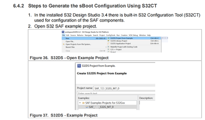

I can not find the example project in s32Ds below.
S32G_SAF_SBOOT_UM:

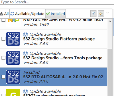

My S32DS:
SW I have installed in S32DS:

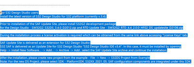

I have install the software as the release note lists:
SW32G2_S32DS_3.4.0_D2012.zip and RTD Update Site - SW32G2_RTD_4.4_2.0.0_HF02_DS_updatesite_D2106.zip
S32G_SAF_1.0.1_ReleaseNotes.txt
