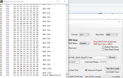

4,029 Views
abdelrhman
Really thank you for your response
but the problem is still the same.
the srec file was flashed successfully and the bootloader started the application. however, the kit didn't respond. the red led shall be on but that didn't happen.

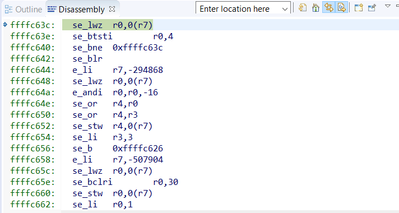

Since you have devkit  -> could you possibly try to attach to running target (Hello World project) after you program srec  using OpenSDA debugger?  this will help to figure out where the execution is.
Go to project Launch configurtation  and select "attach to running target" and press debug button.
Once the debugger connection is established, press Suspend/Pause debug button.
Can you send us the screenshot  of disassembly when you pause the execution?
Stan
4,016 Views
abdelrhman
Hello Stan, I Hope your day is fine
Here is the disassembly screenshot
3,995 Views

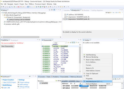

stanish
it seems that an unhandled exception occurred -> the address space belongs to Boot assist module - rom code executed after reset.

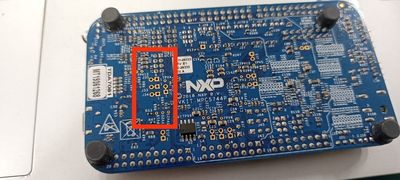

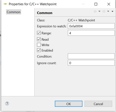

Which DevKit board revision do you use? what is the jumper settings?

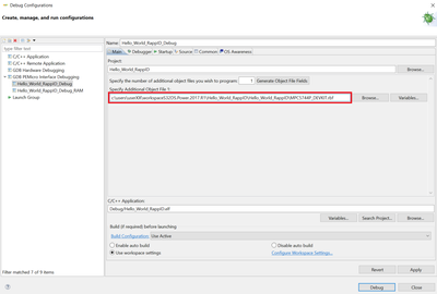

I'd suggest you to debug Hello World Rappid project (FYI: it should loads also program the bootloader - just update the absolute path to rbf file)
then put a breakpoint at app  _start() and perform reset target from the debugger (see screenshot below)
Now run the execution -> do you hit the breakpoint?
If not, please add read watchpoint to address 0xfa0004 (bootloader rchw block - app entry point) and reset from debugger. Do you hit the watchpoint?

abdelrhman
Hi stan
Hope you are well
My Dev board is of revision E.
Jumper settings: debug mode, FAB pin is disconnected

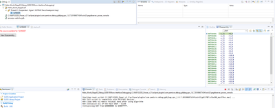

when I put a breakpoint at app  _start() and perform reset target from the debugger, I didnot hit the breakpoint. the kit enters signal trap as follows,
when I read a watchpoint to address 0xfa0004, I got the following
then I reset from debugger, I got the following
