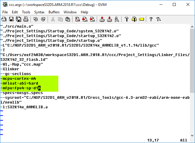

jiri_kral
make sure that you have selected Float ABI to hard:
Also check the .args file if contain all settings:
Sometimes there is missing -mfpu argument. If it is your case - double click on fpv4-sp-d16 option in project properties:
Hope it helps
Jiri

nanshang
I had selected Float ABI to hard, but there is no FP settings in the .args file. It is still missing even after double click on fpv4-sp-d16 option. Then I added it manually, but it returned to th original state after building. After many times of "double click", FP settings finally appeared and errors disappeared.
It seems FP settings in the .args file can appear only after many tries.
Anyway, I can debug now.
Thx.
