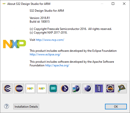

I have a S32DS project which was built using version 2018.R1 (Build id: 180815).
The system which I have has version 2018.R1 (Build id: 180326) installed.
While building the project I am getting
Cannot run program "": Launching failed
Error: Program "" not found in PATH
How to resolve above issue. And how to update build version? Need solution asap.

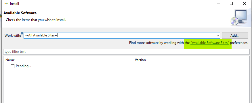

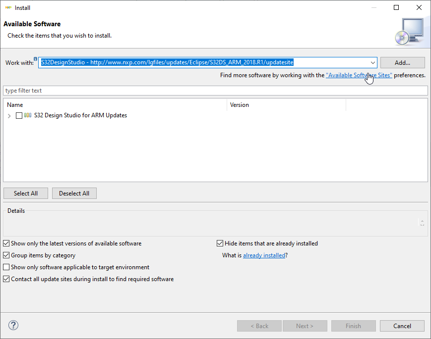

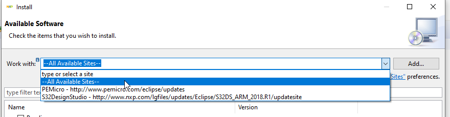

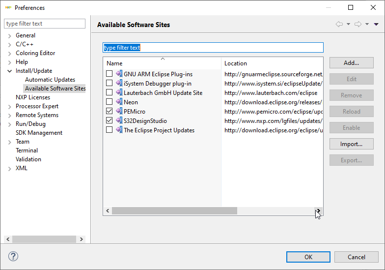

this can be done by update. With fresh install:
On main menu bar click on Help -> Install new Software -> check Available Software sites:
Select S32DesignStudio and PE Micro:
Select all available sites:
and you should be able see what will be updated:
When update is done (it takes a while - it is cumulative update) - the support for MCWT1xxx is added and the build version is as requested:
Hope it helps.

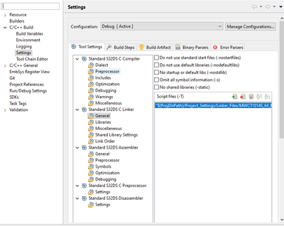

In your project is absolute path for linker script file (the .ld file) - located on Drive
D:/1_git/actual/AWC_MSIL_B_VERSION/awc_msil/Project_Settings/Linker_Files/MWCT1014S_64_flash.ld"
Do you have such folder on your machine? If not, you need add correct location for linker file script in Project Properties:
Jiri

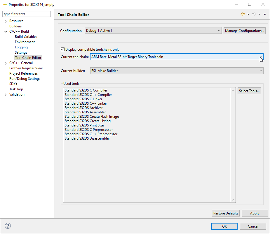

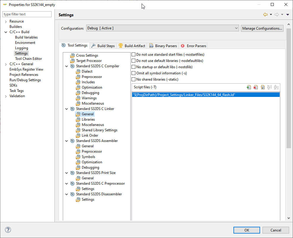

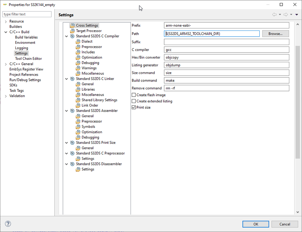

Okay. What is in Project Properties -> Settings -> Cross Settings?
And what is in your toolchain properties:
It is possible share your project - you an send it to [email protected] .  It looks, that there is probably somehow badly setup toolchain. If you imported project, was there some Warning/Error message?

I'm not able reproduce it - but the red line is the cause. Did you tried choose different toolchain from the list?
Jiri

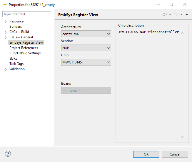

I have attached snapshots of projects settings which are required to build the project.
The outcome of this is that
1. I am able to build the project but there is mismatch in hex file contents.
2. I am not able to select chip: MWCT1014S in "EmbSys Register View" project settings. The only options are S32K* series.
3. there is definitely some issue happening while importing the project
Can you give steps about "How to update S32DS build id from 180326 to 180815"?

jiri_kral
the MWCT10xxS chip is under NXP vendor, not in Freescale - are you able switch from Freescale to NXP in EmbSys register view?
You can update your S32DS installation from Main Menu bar Help -> Install New Software:
Anyway, the latest S32DS version supporting MWCT10xx MCU is S32DS for ARM v2.2 -

jiri_kral
Hope it helps.
Jiri
